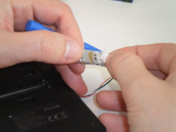

  6. American Weigh AWS -100 Sensor Replacement: crwdns2935265:06crwdnd2935265:01crwdnd2935265:02crwdne2935265:0 American Weigh AWS -100 Sensor Replacement: crwdns2935265:06crwdnd2935265:02crwdnd2935265:02crwdne2935265:0
    • With the sensor detached, use a plastic opening tool to peel away the glue holding the wires.

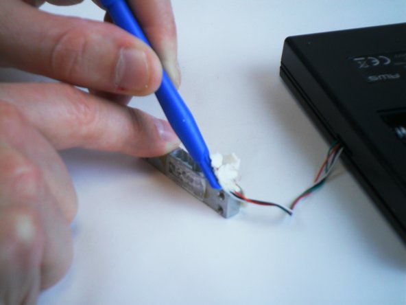

  7. American Weigh AWS -100 Sensor Replacement: crwdns2935265:07crwdnd2935265:01crwdnd2935265:02crwdne2935265:0 American Weigh AWS -100 Sensor Replacement: crwdns2935265:07crwdnd2935265:02crwdnd2935265:02crwdne2935265:0
    • Remove the glue on the third side so that the wires are completely disconnected from the sensor. You should now be able to replace the defective sensor with your new one.
