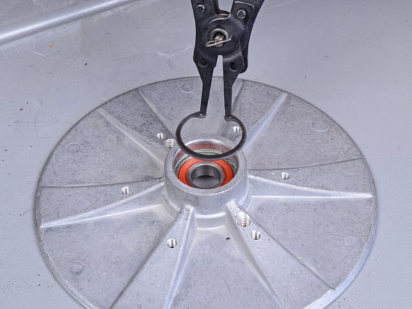

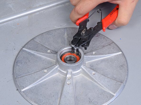

  8. American Sanders EZSand Orbital Sander 07163A 2017 Sanding Disc Replacement, Remove the sanding disc bearing: crwdns2935265:08crwdnd2935265:01crwdnd2935265:03crwdne2935265:0 American Sanders EZSand Orbital Sander 07163A 2017 Sanding Disc Replacement, Remove the sanding disc bearing: crwdns2935265:08crwdnd2935265:02crwdnd2935265:03crwdne2935265:0 American Sanders EZSand Orbital Sander 07163A 2017 Sanding Disc Replacement, Remove the sanding disc bearing: crwdns2935265:08crwdnd2935265:03crwdnd2935265:03crwdne2935265:0
    • Use a pair of snap ring pliers to compress the retaining ring inside the driver and remove it from the sanding disc.
    • It may help to use a small flathead screwdriver to pry out the retaining ring as you remove it.

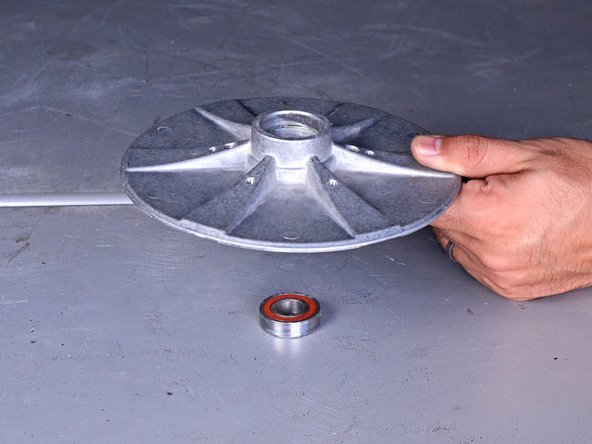

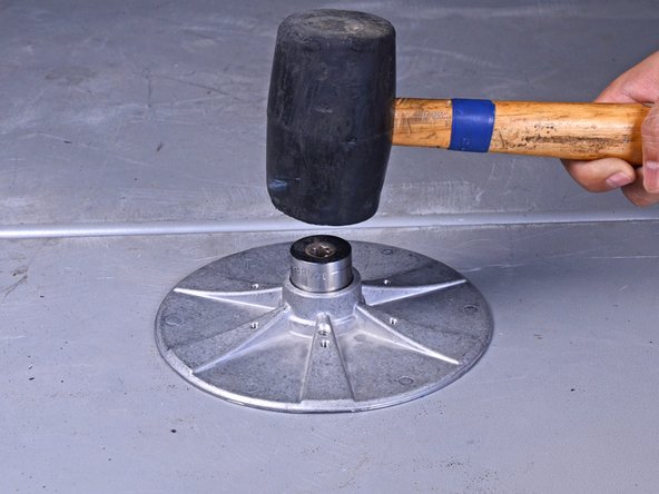

  9. American Sanders EZSand Orbital Sander 07163A 2017 Sanding Disc Replacement: crwdns2935265:09crwdnd2935265:01crwdnd2935265:03crwdne2935265:0 American Sanders EZSand Orbital Sander 07163A 2017 Sanding Disc Replacement: crwdns2935265:09crwdnd2935265:02crwdnd2935265:03crwdne2935265:0 American Sanders EZSand Orbital Sander 07163A 2017 Sanding Disc Replacement: crwdns2935265:09crwdnd2935265:03crwdnd2935265:03crwdne2935265:0
    • Place a 15/16" socket inside the center of the sanding disc and use a mallet to tap the bearing out of the disc.
