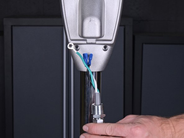

  5. American Sanders EZSand Orbital Sander 07163A 2017 Handle Replacement, Remove the power cord: crwdns2935265:05crwdnd2935265:01crwdnd2935265:01crwdne2935265:0
    • Use a 4 mm hex key to remove the two 13.8 mm-long screws securing the green ground wires to the handle enclosure.
    • These screws have lock washers on them. Be sure to retain the washers for reinstallation.
  6. American Sanders EZSand Orbital Sander 07163A 2017 Handle Replacement: crwdns2935265:06crwdnd2935265:01crwdnd2935265:01crwdne2935265:0
    • Use a 7/8" wrench to loosen the coupling securing the power cord to the handle enclosure.
  7. American Sanders EZSand Orbital Sander 07163A 2017 Handle Replacement: crwdns2935265:07crwdnd2935265:01crwdnd2935265:02crwdne2935265:0 American Sanders EZSand Orbital Sander 07163A 2017 Handle Replacement: crwdns2935265:07crwdnd2935265:02crwdnd2935265:02crwdne2935265:0
    • Pull the power cord straight down, out of the handle.
    • To avoid damaging the wires, remove the power cord slowly and make sure the wires don't snag on anything as they come out.
