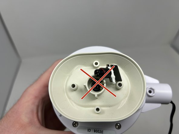

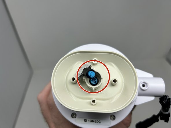

    • Identify the connection between the Thermo-Hygrometer sesnor and the body of the array.
    • The 1st Generation of array does NOT have a removable sensor. It is covered in a white glue.
    • The 2nd and 3rd Generation DO have removable sensor chips. You will see a small black ring, which is the bottom of the sensor mount.
  2. Ambient Weather WS-5000 - Identify Sensor Gen: crwdns2935265:02crwdnd2935265:01crwdnd2935265:02crwdne2935265:0 Ambient Weather WS-5000 - Identify Sensor Gen: crwdns2935265:02crwdnd2935265:02crwdnd2935265:02crwdne2935265:0
    • Remove the screws attaching the Solar Radiation Shield to the body of the array.
    • Remove Solar Radiation Shield fins and set aside.
  3. Ambient Weather WS-5000 - Identify Sensor Gen: crwdns2935265:03crwdnd2935265:01crwdnd2935265:03crwdne2935265:0 Ambient Weather WS-5000 - Identify Sensor Gen: crwdns2935265:03crwdnd2935265:02crwdnd2935265:03crwdne2935265:0 Ambient Weather WS-5000 - Identify Sensor Gen: crwdns2935265:03crwdnd2935265:03crwdnd2935265:03crwdne2935265:0
    • Identify which Generation of Chip the array has.
    • The 1st Generation is NOT removable, and the entire array will need to be replaced.
    • The 2nd Generation IS removable, however, the chip is not replaceable. The entire array will need to be replaced.
    • The 3rd Generation IS removable, and replaceable. A new chip should get the unit up and running again.
