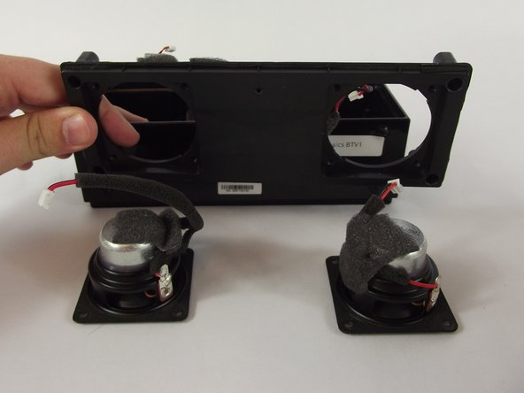

      • Hold the speaker firmly and wedge a plastic opening tool in between the faceplate and the body of the speaker.
      • Move the tool back and forth along the entire perimeter of the face plate until you feel the plate loosen, then pry the plate off.
    2. AmazonBasics BTV1 Speaker Replacement: crwdns2935265:02crwdnd2935265:01crwdnd2935265:02crwdne2935265:0 AmazonBasics BTV1 Speaker Replacement: crwdns2935265:02crwdnd2935265:02crwdnd2935265:02crwdne2935265:0
      • Using a Phillips #1 screwdriver, remove the four black 10mm screws around each of speakers.
      • Using a Phillps #1 screwdriver, remove the four black 10mm screws securing the inside panel to the case.
    3. AmazonBasics BTV1 Speaker Replacement: crwdns2935265:03crwdnd2935265:01crwdnd2935265:02crwdne2935265:0 AmazonBasics BTV1 Speaker Replacement: crwdns2935265:03crwdnd2935265:02crwdnd2935265:02crwdne2935265:0
      • Tilt the case downwards until the speakers fall out of their housings.
      • Reach your thumb and forefinger past the speakers and detach the front speaker panel from the unit.
    4. AmazonBasics BTV1 Speaker Replacement: crwdns2935265:04crwdnd2935265:01crwdnd2935265:02crwdne2935265:0 AmazonBasics BTV1 Speaker Replacement: crwdns2935265:04crwdnd2935265:02crwdnd2935265:02crwdne2935265:0
      • Gently pull the two plastic connectors from the motherboard.
      • Lift the front panel of the case and remove the speakers.
