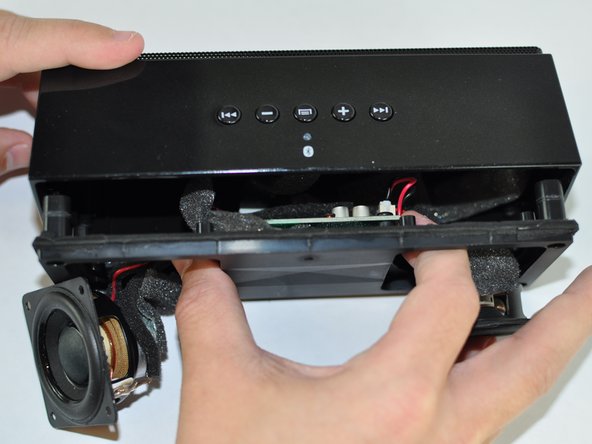

  3. AmazonBasics BTV1 Motherboard Replacement: crwdns2935265:03crwdnd2935265:01crwdnd2935265:02crwdne2935265:0 AmazonBasics BTV1 Motherboard Replacement: crwdns2935265:03crwdnd2935265:02crwdnd2935265:02crwdne2935265:0
    • Tilt the case downwards until the speakers fall out of their housings.
    • Reach your thumb and forefinger past the speakers and detach the front speaker panel from the unit.

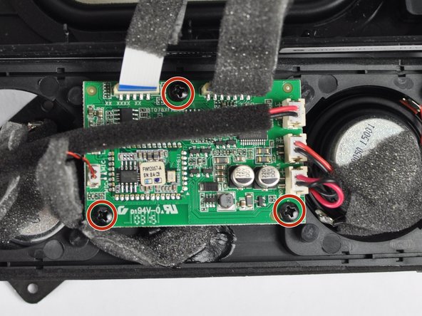

  4. AmazonBasics BTV1 Motherboard Replacement: crwdns2935265:04crwdnd2935265:01crwdnd2935265:02crwdne2935265:0 AmazonBasics BTV1 Motherboard Replacement: crwdns2935265:04crwdnd2935265:02crwdnd2935265:02crwdne2935265:0
    • Gently pull each plastic connector from the motherboard.
    • Take a note of which connector goes with each component for easy reassembly.
    • Use a Phillips #1 screwdriver to remove each of the three black 9.6mm screws from the motherboard.
  5. AmazonBasics BTV1 Motherboard Replacement: crwdns2935265:05crwdnd2935265:01crwdnd2935265:01crwdne2935265:0
    • Gently pull out the two ribbon connectors to disconnect the motherboard from the case.
