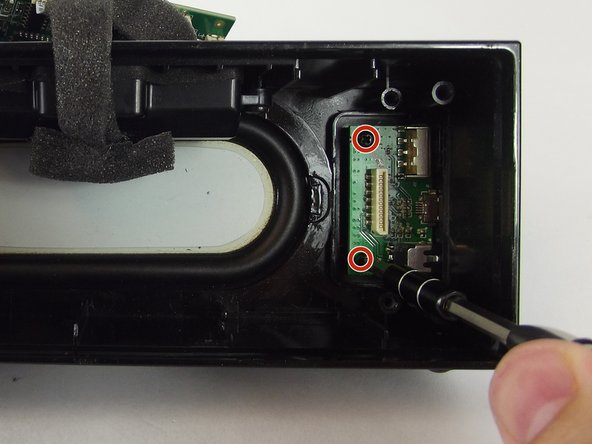

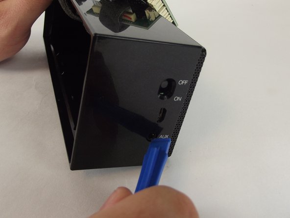

  6. AmazonBasics BTV1 Micro USB Jack Replacement, Micro USB Jack: crwdns2935265:06crwdnd2935265:01crwdnd2935265:03crwdne2935265:0 AmazonBasics BTV1 Micro USB Jack Replacement, Micro USB Jack: crwdns2935265:06crwdnd2935265:02crwdnd2935265:03crwdne2935265:0 AmazonBasics BTV1 Micro USB Jack Replacement, Micro USB Jack: crwdns2935265:06crwdnd2935265:03crwdnd2935265:03crwdne2935265:0
    • Using a Phillips #1 screwdriver, remove the two black 10mm screws on the interior of the case on the side with the USB and AUX inputs.
    • Use the plastic opening tool and tweezers at different points to work the audio input casing off.

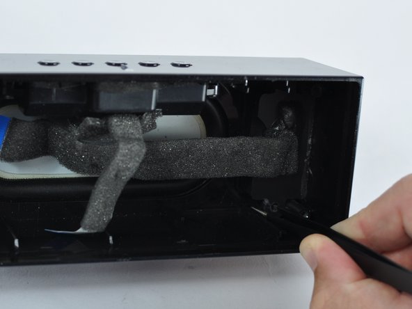

  7. AmazonBasics BTV1 Micro USB Jack Replacement: crwdns2935265:07crwdnd2935265:01crwdnd2935265:02crwdne2935265:0 AmazonBasics BTV1 Micro USB Jack Replacement: crwdns2935265:07crwdnd2935265:02crwdnd2935265:02crwdne2935265:0
    • Use your fingers to pull casing off by the ribbon.
    • Use a Phillips #1 screwdriver to remove the two 7.6mm screws that hold the board in place.

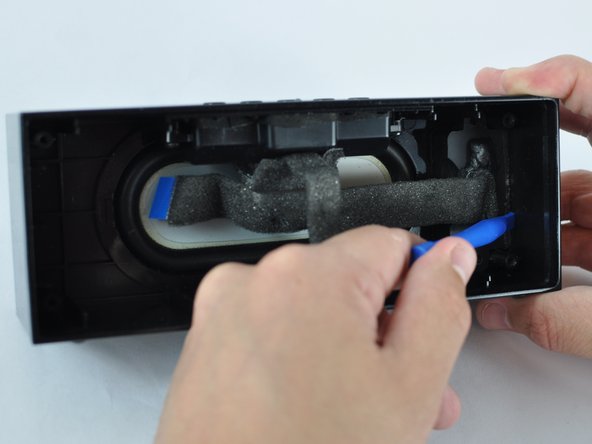

  8. AmazonBasics BTV1 Micro USB Jack Replacement: crwdns2935265:08crwdnd2935265:01crwdnd2935265:02crwdne2935265:0 AmazonBasics BTV1 Micro USB Jack Replacement: crwdns2935265:08crwdnd2935265:02crwdnd2935265:02crwdne2935265:0
    • Use plastic opening tool to lift up the board.
    • Use plastic opening tool to gently push the aux input jack out of its housing.
