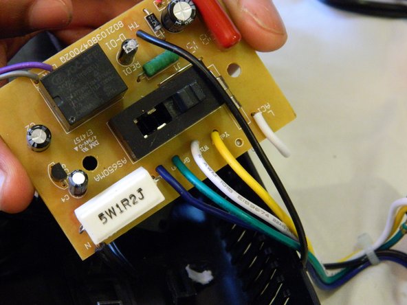

    • Remove the two 10mm PH1 screws holding the motherboard in place.
    • Remove the motherboard by lifting straight upwards from the top cover.
  12. AmazonBasics B00Q3KFX8U Power Switch Replacement: crwdns2935265:012crwdnd2935265:01crwdnd2935265:01crwdne2935265:0
    • To disconnect the power wire, remove the black and white wires on the far edges of the motherboard.
    • To reassemble, solder the wires back to the motherboard in the same location as they previously were.
    • When reassembling, be sure to replace the wires in the correct locations. Reversing the wires will short circuit the motherboard and may damage the device or injure yourself.
  13. AmazonBasics B00Q3KFX8U Power Switch Replacement, Power Switch: crwdns2935265:013crwdnd2935265:01crwdnd2935265:02crwdne2935265:0 AmazonBasics B00Q3KFX8U Power Switch Replacement, Power Switch: crwdns2935265:013crwdnd2935265:02crwdnd2935265:02crwdne2935265:0
    • Remove the switch by unsoldering the 8 solder points on the motherboard.
    • To reinstall, solder the switch back into the same location on the motherboard.
