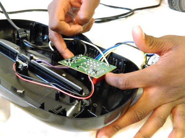

    1. AmazonBasics B00Q3KFX8U Power Cable Replacement, Power Cable: crwdns2935265:010crwdnd2935265:01crwdnd2935265:01crwdne2935265:0
      • Remove the two 8mm PH1 screws holding the IR sensor wire in place. This will give you more room to work with later on.
    2. AmazonBasics B00Q3KFX8U Power Cable Replacement: crwdns2935265:011crwdnd2935265:01crwdnd2935265:02crwdne2935265:0 AmazonBasics B00Q3KFX8U Power Cable Replacement: crwdns2935265:011crwdnd2935265:02crwdnd2935265:02crwdne2935265:0
      • Remove the two 10mm PH1 screws holding the motherboard in place.
      • Remove the motherboard by lifting straight upwards from the top cover.
    3. AmazonBasics B00Q3KFX8U Power Cable Replacement: crwdns2935265:012crwdnd2935265:01crwdnd2935265:01crwdne2935265:0
      • To disconnect the power wire, remove the black and white wires on the far edges of the motherboard.
      • To reassemble, solder the wires back to the motherboard in the same location as they previously were.
      • When reassembling, be sure to replace the wires in the correct locations. Reversing the wires will short circuit the motherboard and may damage the device or injure yourself.
