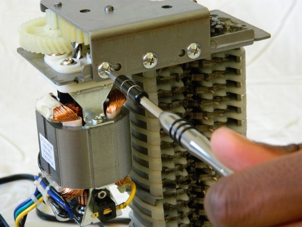

  5. AmazonBasics B00Q3KFX8U Drive Gear Replacement: crwdns2935265:05crwdnd2935265:01crwdnd2935265:02crwdne2935265:0 AmazonBasics B00Q3KFX8U Drive Gear Replacement: crwdns2935265:05crwdnd2935265:02crwdnd2935265:02crwdne2935265:0
    • Remove the five 8mm PH2 screws from the bracket holding the gears in place.

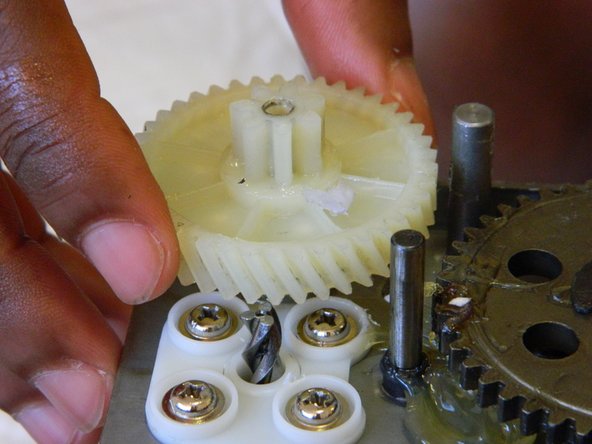

  7. AmazonBasics B00Q3KFX8U Drive Gear Replacement: crwdns2935265:07crwdnd2935265:01crwdnd2935265:02crwdne2935265:0 AmazonBasics B00Q3KFX8U Drive Gear Replacement: crwdns2935265:07crwdnd2935265:02crwdnd2935265:02crwdne2935265:0
    • Remove the two plastic drive gears from the shredder assembly by lifting straight upwards.
