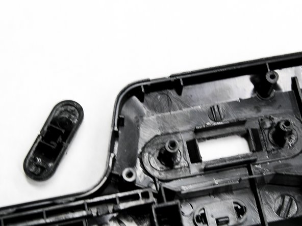

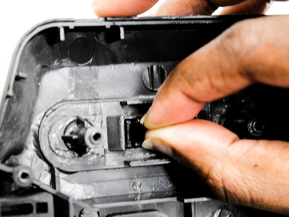

  5. AmazonBasics B0050BPWBQ On/Off Switch Replacement, On/Off Switch: crwdns2935265:05crwdnd2935265:01crwdnd2935265:03crwdne2935265:0 AmazonBasics B0050BPWBQ On/Off Switch Replacement, On/Off Switch: crwdns2935265:05crwdnd2935265:02crwdnd2935265:03crwdne2935265:0 AmazonBasics B0050BPWBQ On/Off Switch Replacement, On/Off Switch: crwdns2935265:05crwdnd2935265:03crwdnd2935265:03crwdne2935265:0
    • Pull the front panel away from the shredding unit.
    • Locate the black On/Off switch attached to the front panel where the control board was once attached.
    • Squeeze the wings of the On/Off switch from the inside of the front panel to detach it from its slot in the panel.
