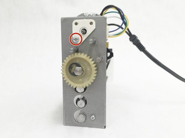

    • Remove the last 15 mm Phillips #1 screw from the plastic triangle piece on the side of the shredding unit.
    • Upon removal of last screw, the motor will become detached.

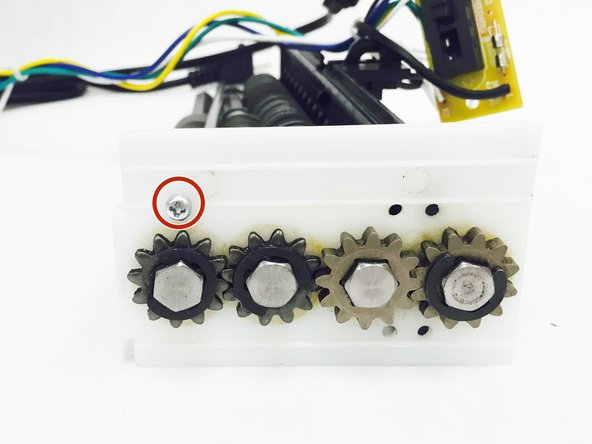

  10. AmazonBasics B0050BPWBQ Activation Sensor Replacement: crwdns2935265:010crwdnd2935265:01crwdnd2935265:01crwdne2935265:0
    • Remove the 15 mm Phillips #1 screw located on the metal side plate of the shredding unit.
  11. AmazonBasics B0050BPWBQ Activation Sensor Replacement: crwdns2935265:011crwdnd2935265:01crwdnd2935265:02crwdne2935265:0 AmazonBasics B0050BPWBQ Activation Sensor Replacement: crwdns2935265:011crwdnd2935265:02crwdnd2935265:02crwdne2935265:0
    • Remove the 15 mm Phillips #1 screw located on the plastic side plate of the shredding unit.
    • Upon removal of this screw, the thin metal bar will become detached from the shredding unit.

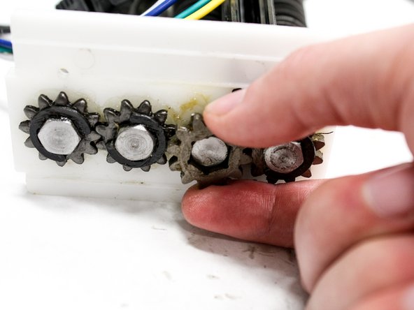

  13. AmazonBasics B0050BPWBQ Activation Sensor Replacement: crwdns2935265:013crwdnd2935265:01crwdnd2935265:02crwdne2935265:0 AmazonBasics B0050BPWBQ Activation Sensor Replacement: crwdns2935265:013crwdnd2935265:02crwdnd2935265:02crwdne2935265:0
    • Remove the washer from the gear second from the right using two metal spudgers. Place one spudger on each of the open ends of the washer. Push down with both spudgers at the same time to pop the washer off the gear.
    • Make sure the gear you are removing is what is attaching the activation sensor to the blades.
    • Pull the gear away from plastic side piece of the shredding unit.

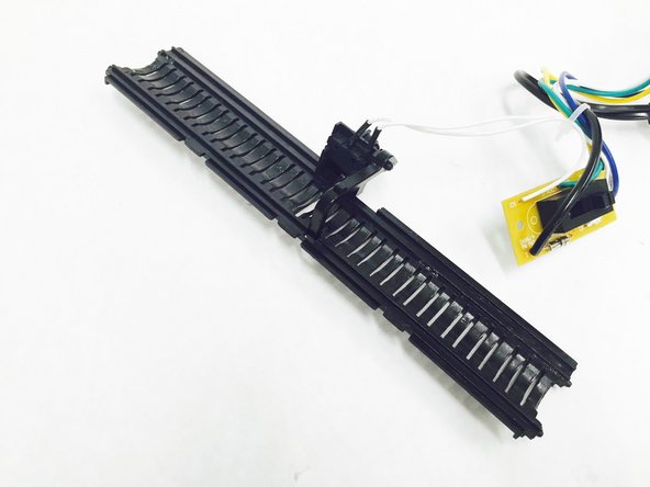

  14. AmazonBasics B0050BPWBQ Activation Sensor Replacement: crwdns2935265:014crwdnd2935265:01crwdnd2935265:01crwdne2935265:0
    • Remove the middle blade from the plastic side piece by pulling it away from the sensor. The blade will fall away from the other attached parts of the unit.
  15. AmazonBasics B0050BPWBQ Activation Sensor Replacement: crwdns2935265:015crwdnd2935265:01crwdnd2935265:02crwdne2935265:0 AmazonBasics B0050BPWBQ Activation Sensor Replacement: crwdns2935265:015crwdnd2935265:02crwdnd2935265:02crwdne2935265:0
    • Unhinge the sensor clamp from the blade by pushing with your thumb and pull the sensor away from the plastic side piece with the other hand to detach the activation sensor from the entire shredding unit.
