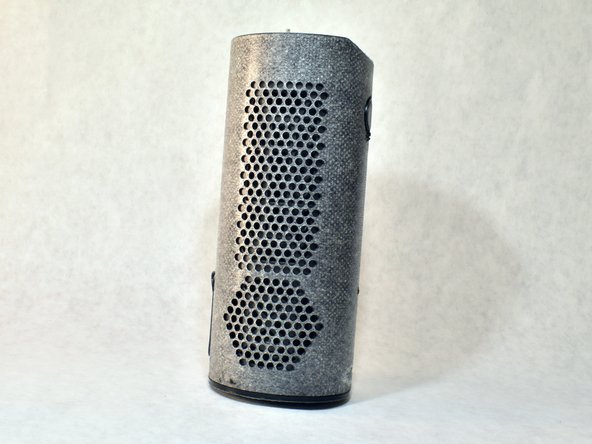

    • Time to break through the Tap's exterior. The only way to disassemble the Tap is from the outside.
    • First, remove the Tap's stretchy fabric wrap. Unroll the stretchy fabric from the sticky cowling.
    • After removing the stretchy fabric completely, the adhesive cowling remains.

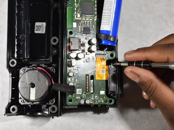

  6. Amazon Tap Battery Replacement: crwdns2935265:06crwdnd2935265:01crwdnd2935265:02crwdne2935265:0 Amazon Tap Battery Replacement: crwdns2935265:06crwdnd2935265:02crwdnd2935265:02crwdne2935265:0
    • Once you remove the buttons its safe to pull apart the Amazon Tap.
    • Here you will find a standard 18650 Lithium Ion cell battery.
    • Carefully remove the Lithium Ion Cell Battery and insert a new one.
To reassemble the Amazon Tap device, follow these instructions in reverse order.
