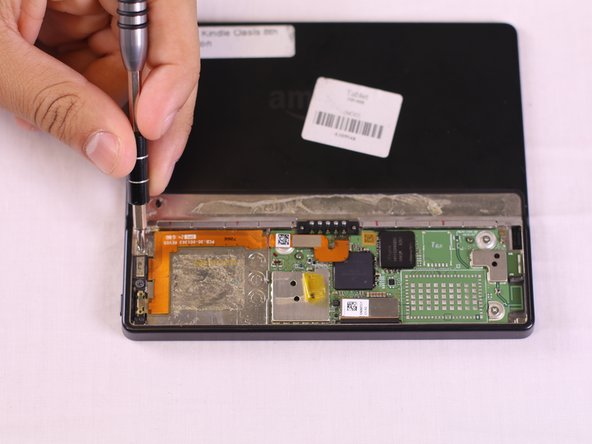

  9. Amazon Kindle Oasis 8th Gen Power Button Replacement, Power Button: crwdns2935265:09crwdnd2935265:01crwdnd2935265:03crwdne2935265:0 Amazon Kindle Oasis 8th Gen Power Button Replacement, Power Button: crwdns2935265:09crwdnd2935265:02crwdnd2935265:03crwdne2935265:0 Amazon Kindle Oasis 8th Gen Power Button Replacement, Power Button: crwdns2935265:09crwdnd2935265:03crwdnd2935265:03crwdne2935265:0
    • Locate the 2 Phillips screws (labeled PH 0) and remove screws using a screwdriver with a PH0 bit.

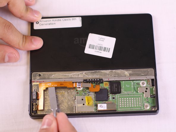

  10. Amazon Kindle Oasis 8th Gen Power Button Replacement: crwdns2935265:010crwdnd2935265:01crwdnd2935265:03crwdne2935265:0 Amazon Kindle Oasis 8th Gen Power Button Replacement: crwdns2935265:010crwdnd2935265:02crwdnd2935265:03crwdne2935265:0 Amazon Kindle Oasis 8th Gen Power Button Replacement: crwdns2935265:010crwdnd2935265:03crwdnd2935265:03crwdne2935265:0
    • Using the metal spudger, tweezers, and your finger tips, gently lift the orange power bridge connector off of the motherboard first and then off of the kindle.
  11. Amazon Kindle Oasis 8th Gen Power Button Replacement: crwdns2935265:011crwdnd2935265:01crwdnd2935265:02crwdne2935265:0 Amazon Kindle Oasis 8th Gen Power Button Replacement: crwdns2935265:011crwdnd2935265:02crwdnd2935265:02crwdne2935265:0
    • Use the tweezers to pluck the orange bridge power connector from the Kindle. The power button is attached to the connector.
