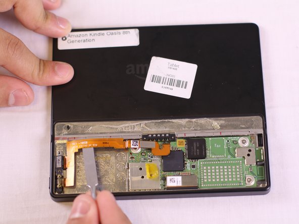

    • Using the metal spudger, tweezers, and your finger tips, gently lift the orange power bridge connector off of the motherboard first and then off of the kindle.
  11. Amazon Kindle Oasis 8th Gen Motherboard Replacement: crwdns2935265:011crwdnd2935265:01crwdnd2935265:02crwdne2935265:0 Amazon Kindle Oasis 8th Gen Motherboard Replacement: crwdns2935265:011crwdnd2935265:02crwdnd2935265:02crwdne2935265:0
    • Use the tweezers to pluck the orange bridge power connector from the Kindle. The charging port and power button is attached to the connector.

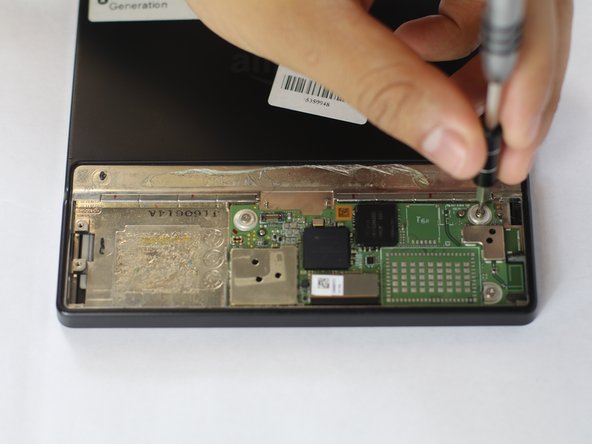

  12. Amazon Kindle Oasis 8th Gen Motherboard Replacement, Motherboard: crwdns2935265:012crwdnd2935265:01crwdnd2935265:03crwdne2935265:0 Amazon Kindle Oasis 8th Gen Motherboard Replacement, Motherboard: crwdns2935265:012crwdnd2935265:02crwdnd2935265:03crwdne2935265:0 Amazon Kindle Oasis 8th Gen Motherboard Replacement, Motherboard: crwdns2935265:012crwdnd2935265:03crwdnd2935265:03crwdne2935265:0
    • Locate the 3 Phillips screws (PH 0) on the motherboard and proceed to unscrew them using a screwdriver with a PH 0 bit.

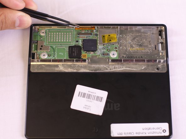

  13. Amazon Kindle Oasis 8th Gen Motherboard Replacement: crwdns2935265:013crwdnd2935265:01crwdnd2935265:02crwdne2935265:0 Amazon Kindle Oasis 8th Gen Motherboard Replacement: crwdns2935265:013crwdnd2935265:02crwdnd2935265:02crwdne2935265:0
    • Locate the connector from the display screen on the motherboard and disconnect it with tweezers

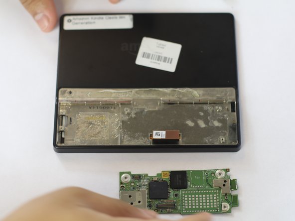

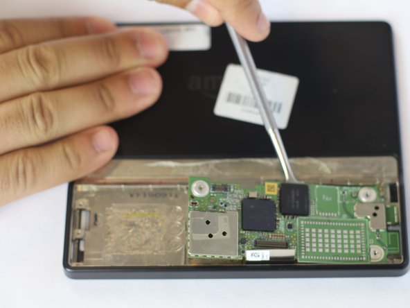

  14. Amazon Kindle Oasis 8th Gen Motherboard Replacement: crwdns2935265:014crwdnd2935265:01crwdnd2935265:03crwdne2935265:0 Amazon Kindle Oasis 8th Gen Motherboard Replacement: crwdns2935265:014crwdnd2935265:02crwdnd2935265:03crwdne2935265:0 Amazon Kindle Oasis 8th Gen Motherboard Replacement: crwdns2935265:014crwdnd2935265:03crwdnd2935265:03crwdne2935265:0
    • Use the metal spudger to wedge out the motherboard from the Kindle.
