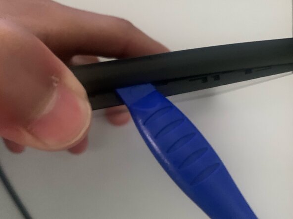

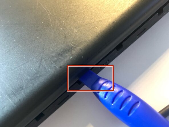

    • Insert the plastic prying tool along the edge of the tablet, where the back cover meets the screen's bezel.
    • Carefully work your way around the edges to free all of the clips that secure the back cover in place.
  2. Amazon Kindle Fire 7th Generation Battery Replacement, Remove the back cover: crwdns2935265:02crwdnd2935265:01crwdnd2935265:02crwdne2935265:0 Amazon Kindle Fire 7th Generation Battery Replacement, Remove the back cover: crwdns2935265:02crwdnd2935265:02crwdnd2935265:02crwdne2935265:0
    • Separate the back cover from the tablet.

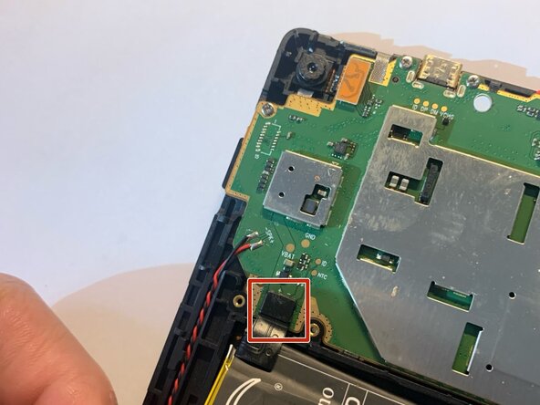

  3. Amazon Kindle Fire 7th Generation Battery Replacement, Remove the battery terminal cover: crwdns2935265:03crwdnd2935265:01crwdnd2935265:02crwdne2935265:0 Amazon Kindle Fire 7th Generation Battery Replacement, Remove the battery terminal cover: crwdns2935265:03crwdnd2935265:02crwdnd2935265:02crwdne2935265:0
    • Remove the two screws that secure the battery connector cover in place with a #00 Phillips screwdriver.
    • Lift the battery connector cover off.
    • Remember to put the screws & battery connector cover aside where you don't lose them.

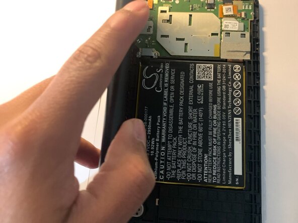

  4. Amazon Kindle Fire 7th Generation Battery Replacement: crwdns2935265:04crwdnd2935265:01crwdnd2935265:02crwdne2935265:0 Amazon Kindle Fire 7th Generation Battery Replacement: crwdns2935265:04crwdnd2935265:02crwdnd2935265:02crwdne2935265:0
    • Disconnect the battery.

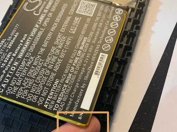

    • Fit the tip of the plastic opening tool under the bottom right of the battery.
    • Remove the battery from the frame.
