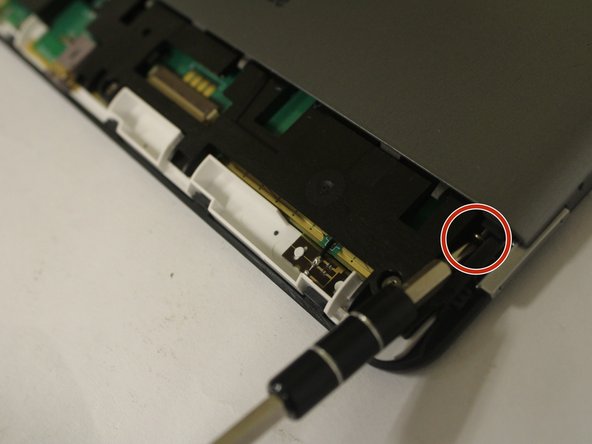

  4. Amazon Kindle DX Previous Page Key Replacement: crwdns2935265:04crwdnd2935265:01crwdnd2935265:02crwdne2935265:0 Amazon Kindle DX Previous Page Key Replacement: crwdns2935265:04crwdnd2935265:02crwdnd2935265:02crwdne2935265:0
    • Remove two 40 mm screws (one on each corner) using a Phillips #00 screwdriver.

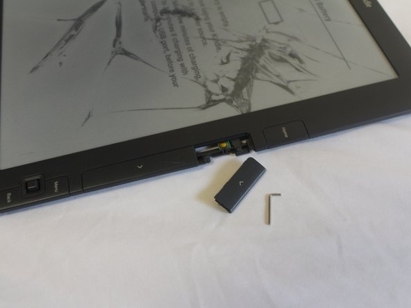

  10. Amazon Kindle DX Previous Page Key Replacement: crwdns2935265:010crwdnd2935265:01crwdnd2935265:02crwdne2935265:0 Amazon Kindle DX Previous Page Key Replacement: crwdns2935265:010crwdnd2935265:02crwdnd2935265:02crwdne2935265:0
    • Remove the "previous page" button from the side function keys using a pair of tweezers.
