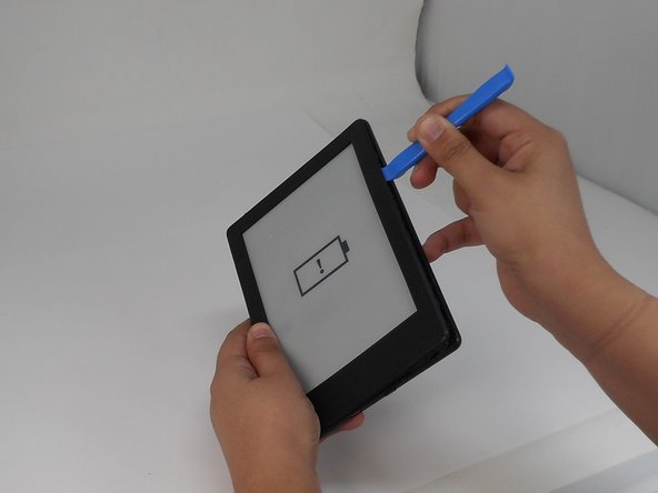

    • Insert the iFixit opening tool into any corner of the Kindle’s front cover.
    • Gently slide the tool along the edges and carefully separate the front cover from the inner front cover.
    • Keep even pressure to avoid any cracks.
    • Lift front cover once all clips are disengaged.
    • Lift the screen gently so that it is not cracked.

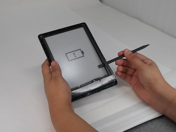

    • Insert the spudger between the inner cover and the screen.
    • Gently work your way around to loosen the front cover.
    • Carefully lift the front cover from the device.

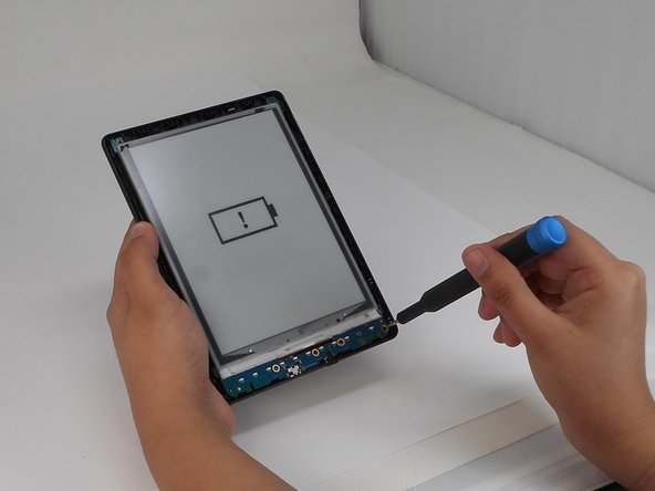

    • Use a T4 Torx screwdriver to remove the seven 3 mm screws around the perimeter of the device.

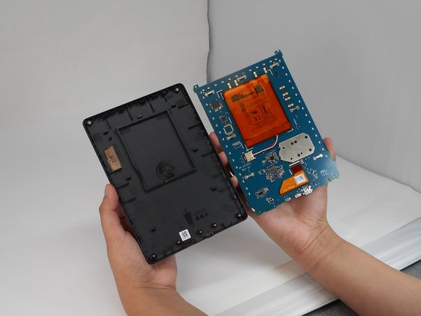

    • Lift the screen and motherboard from the back cover.
  5. Amazon Kindle 8 Power Button Replacement, Power Button: crwdns2935265:05crwdnd2935265:01crwdnd2935265:02crwdne2935265:0 Amazon Kindle 8 Power Button Replacement, Power Button: crwdns2935265:05crwdnd2935265:02crwdnd2935265:02crwdne2935265:0

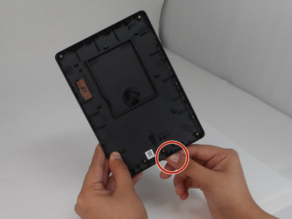

    • On the back cover, from the outside of the kindle, use your finger to push the power button through its hole.
    • Remove the power button.
