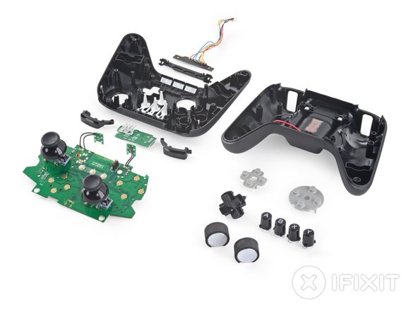

    • But wait...there's more! Round three of this teardown brings us to the gaming controller.
    • The controller is tamper-proofed with a variant of the tri-wing screw family. They look cool and resemble shurikens, but we don't know anybody who keeps a shuriken driver on their tool belt.
    • We do keep a tri-wing driver on ours. It's not a perfect fit, but the Pro Tech Screwdriver Set comes through in the clutch.
    • Outwitting the strange screws, we pop this controller open. At least there's no adhesive keeping it shut.
    • And to complete the trifecta, there lies the controller's RFID tag.

    • Next we pull the trigger...off the controller's motherboard.
    • We've touched the Flying Spaghetti Monster motherboard, and we're ready for some tasty treats:
    • CSR CSR8670 audio and Bluetooth system-on-chip
    • NXP LPC812 Cortex-M0+ 32-bit microcontroller
    • Winbond 25Q16DW serial flash memory with dual and quad SPI
    • Texas Instruments HC595 8-bit shift registers
    • NXP HC4052 dual 4-channel analog multiplexer/demultiplexer
    • Boy howdy, it's your lucky day, reader! A second (gamier) layout, just for you.
