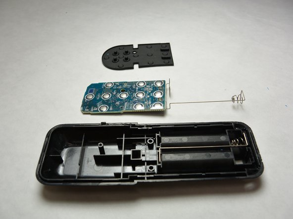

    • Use a plastic opening tool to open the battery cover. Apply a small amount of force into the crease.
    • Remove batteries.
  2. Amazon Fire TV Stick Remote Motherboard Replacement: crwdns2935265:02crwdnd2935265:01crwdnd2935265:03crwdne2935265:0 Amazon Fire TV Stick Remote Motherboard Replacement: crwdns2935265:02crwdnd2935265:02crwdnd2935265:03crwdne2935265:0 Amazon Fire TV Stick Remote Motherboard Replacement: crwdns2935265:02crwdnd2935265:03crwdnd2935265:03crwdne2935265:0
    • Use a plastic opening tool to pry off the top black ring.
  3. Amazon Fire TV Stick Remote Motherboard Replacement: crwdns2935265:03crwdnd2935265:01crwdnd2935265:02crwdne2935265:0 Amazon Fire TV Stick Remote Motherboard Replacement: crwdns2935265:03crwdnd2935265:02crwdnd2935265:02crwdne2935265:0
    • Remove the 6mm triangle head screw on the front of the remote.
  4. Amazon Fire TV Stick Remote Motherboard Replacement: crwdns2935265:04crwdnd2935265:01crwdnd2935265:03crwdne2935265:0 Amazon Fire TV Stick Remote Motherboard Replacement: crwdns2935265:04crwdnd2935265:02crwdnd2935265:03crwdne2935265:0 Amazon Fire TV Stick Remote Motherboard Replacement: crwdns2935265:04crwdnd2935265:03crwdnd2935265:03crwdne2935265:0
    • Use two plastic opening tools to pry along the seam of the remote and separate the face plate.
  5. Amazon Fire TV Stick Remote Motherboard Replacement: crwdns2935265:05crwdnd2935265:01crwdnd2935265:03crwdne2935265:0 Amazon Fire TV Stick Remote Motherboard Replacement: crwdns2935265:05crwdnd2935265:02crwdnd2935265:03crwdne2935265:0 Amazon Fire TV Stick Remote Motherboard Replacement: crwdns2935265:05crwdnd2935265:03crwdnd2935265:03crwdne2935265:0
    • Lift the rubber pad from the motherboard.
  6. Amazon Fire TV Stick Remote Motherboard Replacement: crwdns2935265:06crwdnd2935265:01crwdnd2935265:02crwdne2935265:0 Amazon Fire TV Stick Remote Motherboard Replacement: crwdns2935265:06crwdnd2935265:02crwdnd2935265:02crwdne2935265:0
    • Use the opening tool to lift the back of the motherboard. Slowly lift the motherboard while keeping the wires straight.
