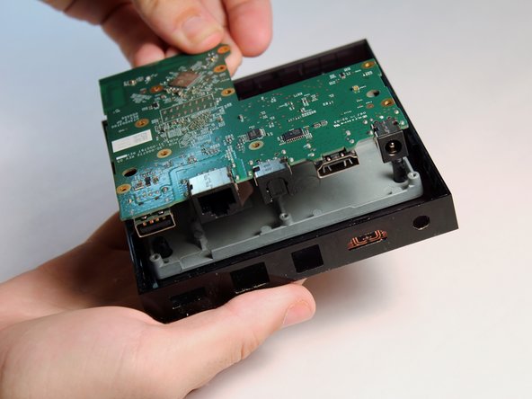

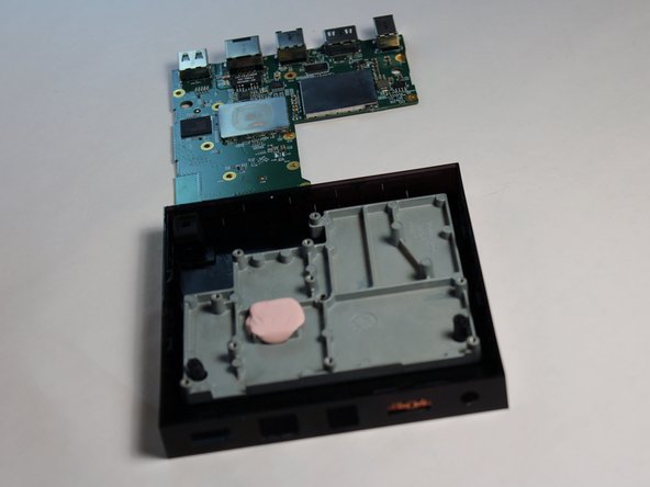

    • Place your finger on the short edge of the motherboard and lift it to separate it from the plastic case.
  4. Amazon Fire TV Power Cord Port Replacement, Power Cord Port: crwdns2935265:04crwdnd2935265:01crwdnd2935265:03crwdne2935265:0 Amazon Fire TV Power Cord Port Replacement, Power Cord Port: crwdns2935265:04crwdnd2935265:02crwdnd2935265:03crwdne2935265:0 Amazon Fire TV Power Cord Port Replacement, Power Cord Port: crwdns2935265:04crwdnd2935265:03crwdnd2935265:03crwdne2935265:0
    • With the mother board back facing you locate the power cord port found on the far left end.
  5. Amazon Fire TV Power Cord Port Replacement: crwdns2935265:05crwdnd2935265:01crwdnd2935265:03crwdne2935265:0 Amazon Fire TV Power Cord Port Replacement: crwdns2935265:05crwdnd2935265:02crwdnd2935265:03crwdne2935265:0 Amazon Fire TV Power Cord Port Replacement: crwdns2935265:05crwdnd2935265:03crwdnd2935265:03crwdne2935265:0
    • Locate the four soldering joints for the power cord port found on the top side of the mother board.
    • Desolder the joints of the power cord port to release it from the motherboard.
