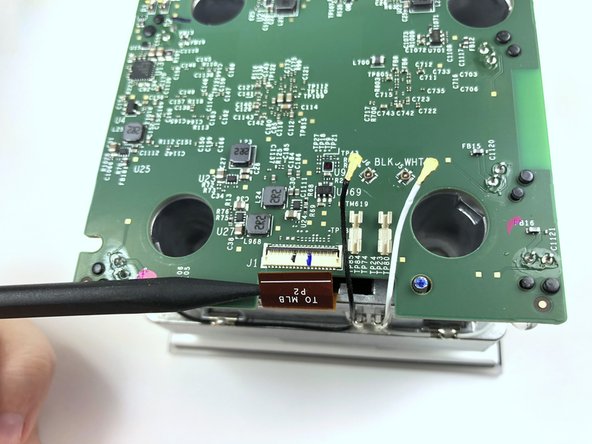

      • Use the pointed end of the Spudger to carefully detach the black and white wires from the motherboard.
      • Make sure all three attachments (the copper tab and both wires) are fully disconnected before continuing.

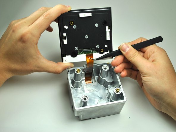

      • Detach the wires from the opposite end of the frame using the flat end of the Spudger.
      • You can’t see where the wires are attached because it is hidden underneath the white frame.
      • Make sure both wire attachments are fully disconnected before continuing.

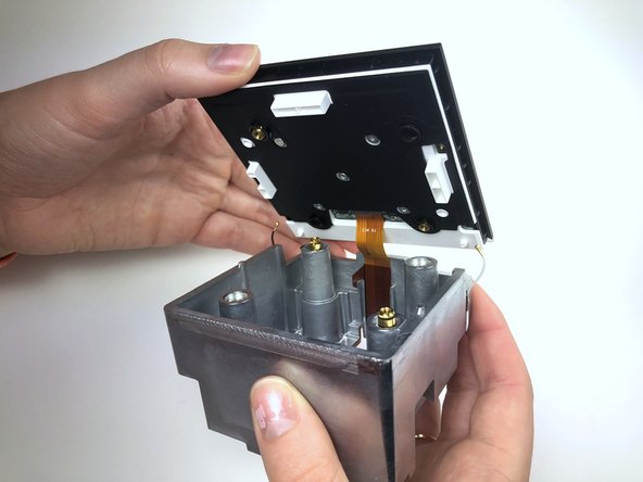

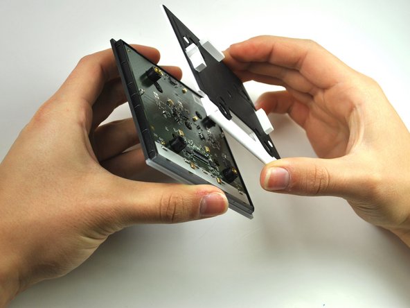

      • Pry apart the black plastic face from metal frame.
      • This requires substantial force.
      • Be careful not to tear connecting copper tab.

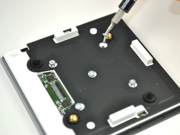

      • Unscrew the five T-6 quarter inch screws.

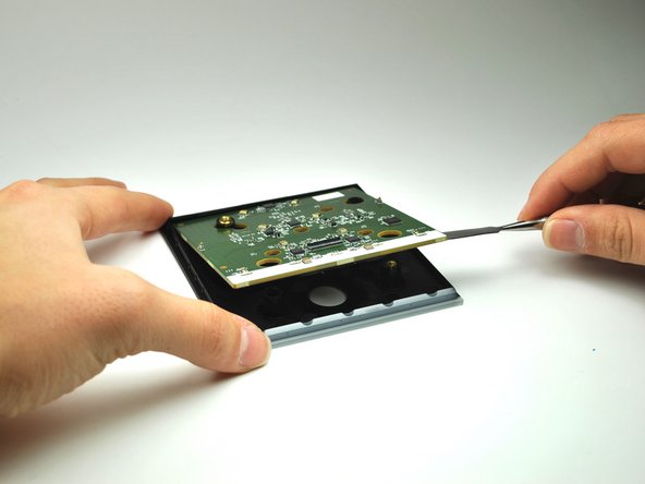

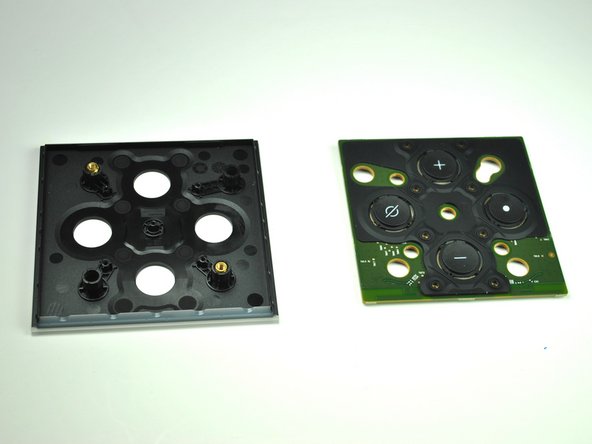

      • Using a the Metal Spudger, pry up the circuit board to reveal a rubber button panel.
    7. Amazon Fire TV Cube Button  Replacement: crwdns2935265:014crwdnd2935265:01crwdnd2935265:02crwdne2935265:0 Amazon Fire TV Cube Button  Replacement: crwdns2935265:014crwdnd2935265:02crwdnd2935265:02crwdne2935265:0

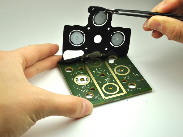

      • Peel back the rubber button casing.
      • Pay close attention to the orientation of the rubber casing.

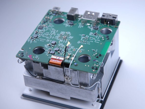

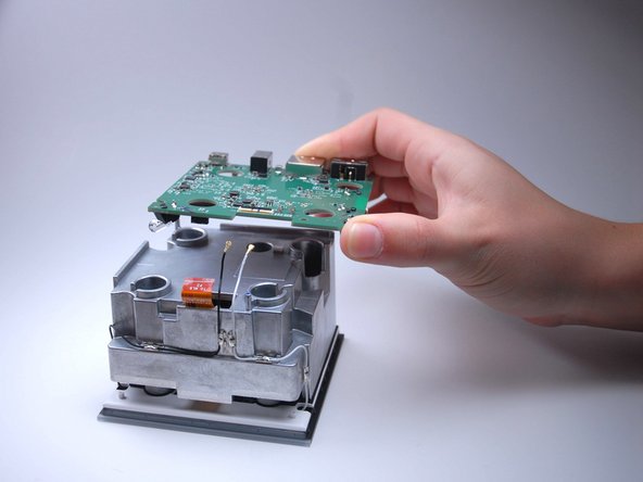

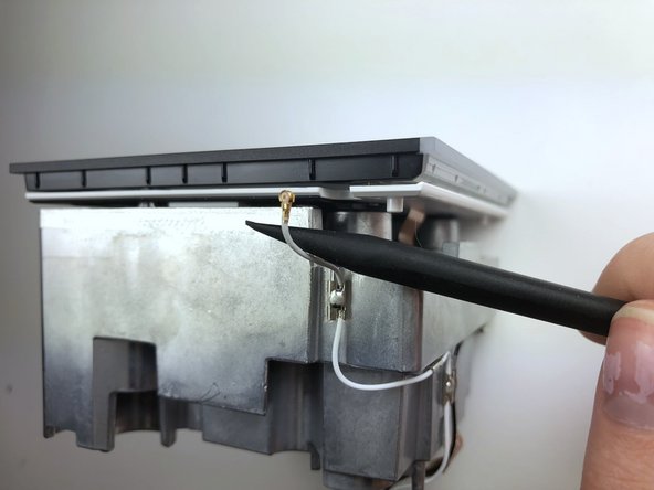

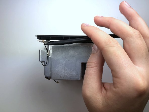

A suggestion for step 8: the antenna wires are not soldered to the aluminum heatsink; they are soldered to small clips that are easily popped off from the heatsink. I found it much easier to pop off all the clips and free the antenna wires from the heatsink than try to remove the antenna connectors from the top circuit board while it is still attached to the frame. After removing the top circuit board from the frame, it’s then much easier to remove the antenna connectors.
