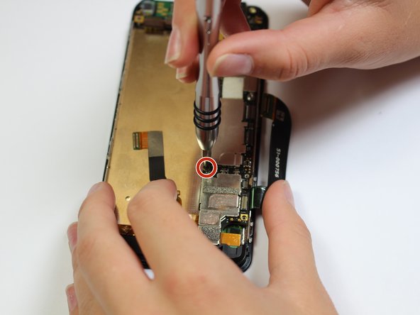

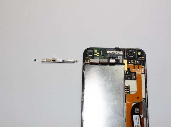

  4. Amazon Fire Phone Rear Facing Camera Replacement, Remove Bracket: crwdns2935265:04crwdnd2935265:01crwdnd2935265:01crwdne2935265:0
    • Using the J000 screwdriver head, remove the three 3mm screws holding the bracket in place.
    • Remove the silver bracket that was held into place by the three screws just removed.

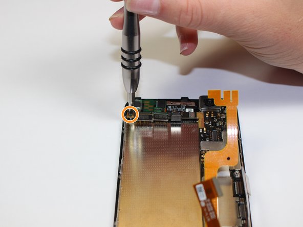

  5. Amazon Fire Phone Rear Facing Camera Replacement, Disconnect Battery: crwdns2935265:05crwdnd2935265:01crwdnd2935265:01crwdne2935265:0
    • Disconnect the battery connection cable by using the plastic opening tool and applying light pressure upwards on the cable.

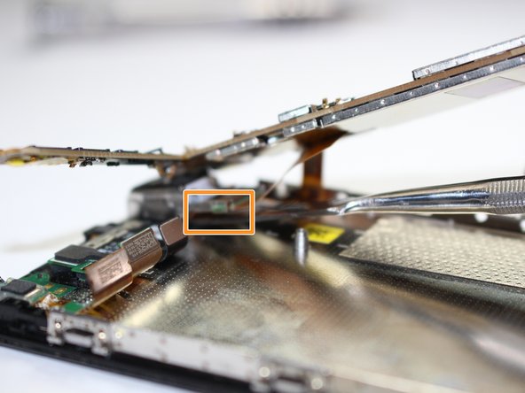

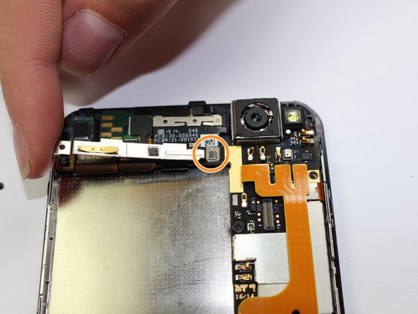

  6. Amazon Fire Phone Rear Facing Camera Replacement, Rear Facing Camera: crwdns2935265:06crwdnd2935265:01crwdnd2935265:03crwdne2935265:0 Amazon Fire Phone Rear Facing Camera Replacement, Rear Facing Camera: crwdns2935265:06crwdnd2935265:02crwdnd2935265:03crwdne2935265:0 Amazon Fire Phone Rear Facing Camera Replacement, Rear Facing Camera: crwdns2935265:06crwdnd2935265:03crwdnd2935265:03crwdne2935265:0
    • Unscrew the one 1mm standoff screws holding the bracket in place along the top of the phone.
    • Carefully slide the bracket out of the tap and then maneuver the bracket off slowly.

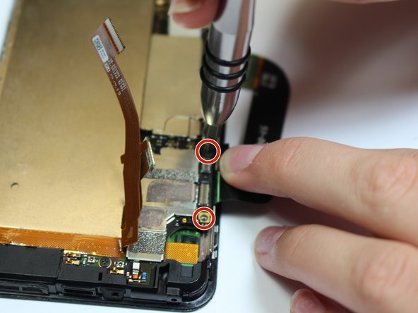

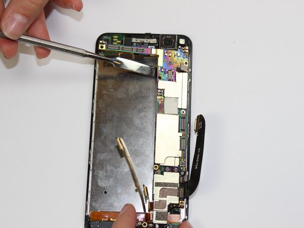

  7. Amazon Fire Phone Rear Facing Camera Replacement: crwdns2935265:07crwdnd2935265:01crwdnd2935265:03crwdne2935265:0 Amazon Fire Phone Rear Facing Camera Replacement: crwdns2935265:07crwdnd2935265:02crwdnd2935265:03crwdne2935265:0 Amazon Fire Phone Rear Facing Camera Replacement: crwdns2935265:07crwdnd2935265:03crwdnd2935265:03crwdne2935265:0
    • Disconnect the 9 cables along the top and right side of motherboard using a spudger.
    • Unscrew the 3mm screw located on the top left side of the phone with a flat head.
    • Disconnect the cable in order to expose the 5 screws along the right hand side of the motherboard.
  8. Amazon Fire Phone Rear Facing Camera Replacement: crwdns2935265:08crwdnd2935265:01crwdnd2935265:03crwdne2935265:0 Amazon Fire Phone Rear Facing Camera Replacement: crwdns2935265:08crwdnd2935265:02crwdnd2935265:03crwdne2935265:0 Amazon Fire Phone Rear Facing Camera Replacement: crwdns2935265:08crwdnd2935265:03crwdnd2935265:03crwdne2935265:0
    • Unscrew four 2mm screws to remove the motherboard.

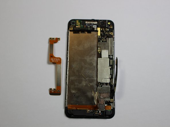

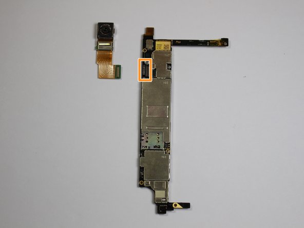

  9. Amazon Fire Phone Rear Facing Camera Replacement: crwdns2935265:09crwdnd2935265:01crwdnd2935265:03crwdne2935265:0 Amazon Fire Phone Rear Facing Camera Replacement: crwdns2935265:09crwdnd2935265:02crwdnd2935265:03crwdne2935265:0 Amazon Fire Phone Rear Facing Camera Replacement: crwdns2935265:09crwdnd2935265:03crwdnd2935265:03crwdne2935265:0
    • Unscrew the remaining 2 mm screw to remove the motherboard.
    • Carefully lift up the motherboard and use the spudger to pry the camera from the camera holder.
    • Lift off the bottom plastic piece with flat antenna cables.

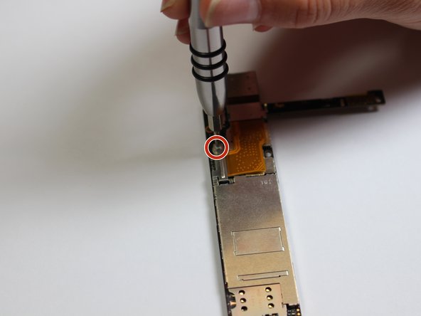

  10. Amazon Fire Phone Rear Facing Camera Replacement: crwdns2935265:010crwdnd2935265:01crwdnd2935265:03crwdne2935265:0 Amazon Fire Phone Rear Facing Camera Replacement: crwdns2935265:010crwdnd2935265:02crwdnd2935265:03crwdne2935265:0 Amazon Fire Phone Rear Facing Camera Replacement: crwdns2935265:010crwdnd2935265:03crwdnd2935265:03crwdne2935265:0
    • Flip the motherboard over.
    • Using a philips head screwdriver to remove the remaining 1mm screw holding the bracket that is protecting the camera ribbon cable.
    • Remove the ribbon cable and rear facing camera carefully.
