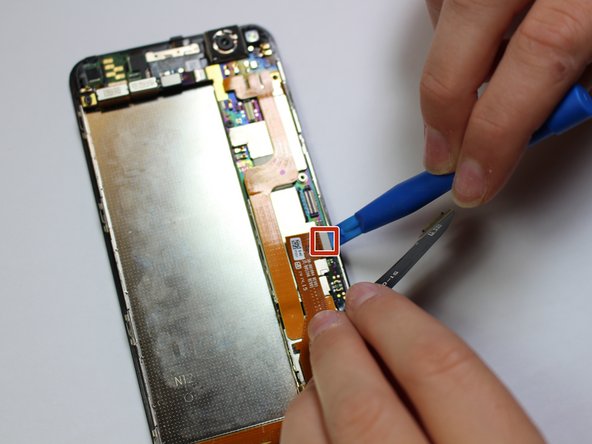

      • Disconnect the 9 cables along the top and right side of motherboard using the plastic opening tool
    3. Amazon Fire Phone Display Replacement: crwdns2935265:08crwdnd2935265:01crwdnd2935265:01crwdne2935265:0

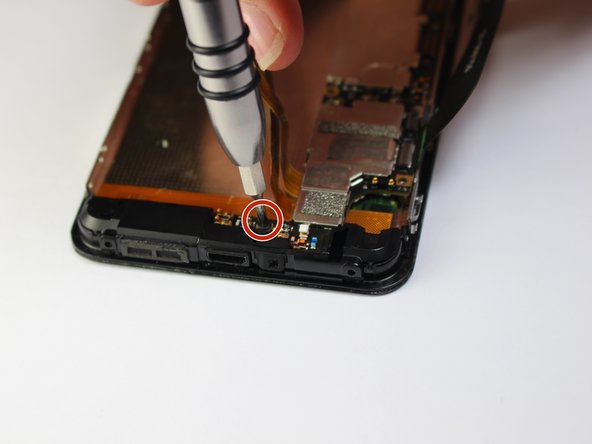

      • Unscrew the 3mm screw located on the top left side of the phone with a flat head

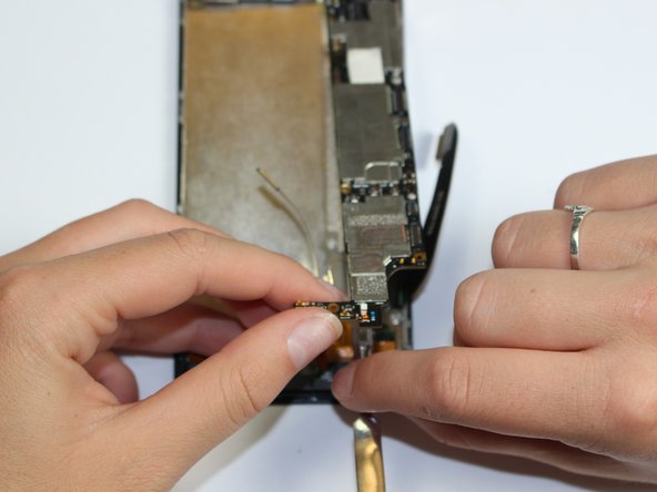

      • Carefully lift up the motherboard and using the spudger pry camera from the camera holder

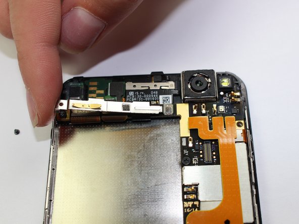

    6. Amazon Fire Phone Display Replacement: crwdns2935265:011crwdnd2935265:01crwdnd2935265:01crwdne2935265:0
      • Lift off bottom plastic piece with flat antenna cables

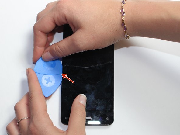

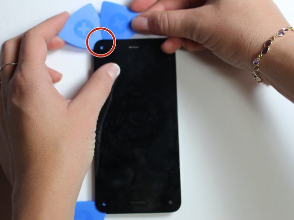

    3. Amazon Fire Phone Display Replacement: crwdns2935265:014crwdnd2935265:01crwdnd2935265:03crwdne2935265:0 Amazon Fire Phone Display Replacement: crwdns2935265:014crwdnd2935265:02crwdnd2935265:03crwdne2935265:0 Amazon Fire Phone Display Replacement: crwdns2935265:014crwdnd2935265:03crwdnd2935265:03crwdne2935265:0
      • Using the Suction Cup to slightly lift the screen, pry one opening pick into side of the phone.
      • Insert another opening pick next to the first one.
      • Slowly slide the two Picks to the corners of the phone.

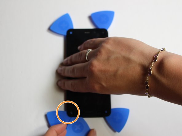

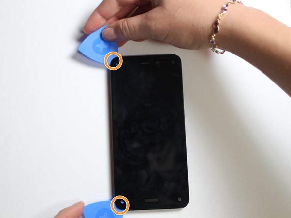

    4. Amazon Fire Phone Display Replacement: crwdns2935265:015crwdnd2935265:01crwdnd2935265:03crwdne2935265:0 Amazon Fire Phone Display Replacement: crwdns2935265:015crwdnd2935265:02crwdnd2935265:03crwdne2935265:0 Amazon Fire Phone Display Replacement: crwdns2935265:015crwdnd2935265:03crwdnd2935265:03crwdne2935265:0
      • Place the iOpener on side 2 of the phone for 90 seconds.
      • Insert another pick into side 2 of the phone.
      • Slowly slide the pick to the next corner.
      • If necessary, reheat the iOpener. Don't reheat it more than once every 3 minutes.

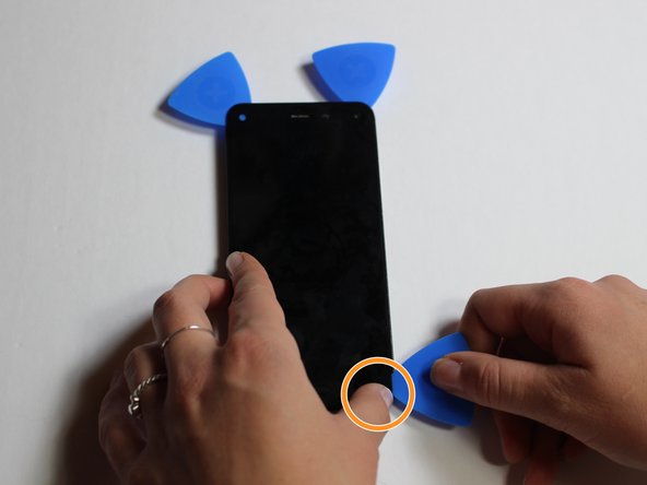

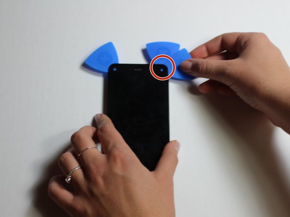

    5. Amazon Fire Phone Display Replacement: crwdns2935265:016crwdnd2935265:01crwdnd2935265:03crwdne2935265:0 Amazon Fire Phone Display Replacement: crwdns2935265:016crwdnd2935265:02crwdnd2935265:03crwdne2935265:0 Amazon Fire Phone Display Replacement: crwdns2935265:016crwdnd2935265:03crwdnd2935265:03crwdne2935265:0
      • Place the iOpener on the 3rd side of the phone for 90 seconds.
      • Place a pick in the corner of the phone.
      • Slowly slide the the pick to the opposite corner of the phone.

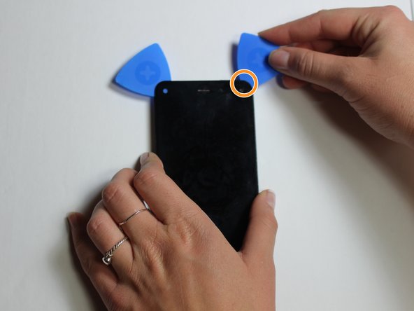

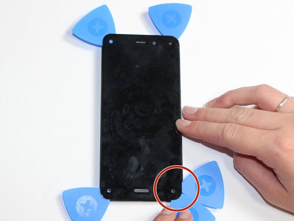

    6. Amazon Fire Phone Display Replacement: crwdns2935265:017crwdnd2935265:01crwdnd2935265:03crwdne2935265:0 Amazon Fire Phone Display Replacement: crwdns2935265:017crwdnd2935265:02crwdnd2935265:03crwdne2935265:0 Amazon Fire Phone Display Replacement: crwdns2935265:017crwdnd2935265:03crwdnd2935265:03crwdne2935265:0
      • Place the iOpener on the last edge of the phone for 90 seconds.
      • Place the pick in the corner.
      • Slowly slide the pick to the opposite corner.
