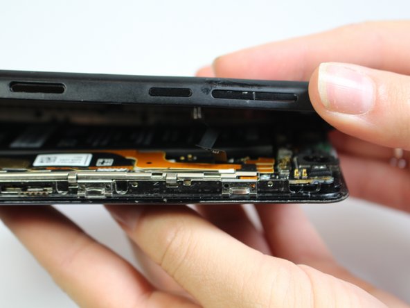

    3. Amazon Fire Phone Battery Replacement: crwdns2935265:03crwdnd2935265:01crwdnd2935265:03crwdne2935265:0 Amazon Fire Phone Battery Replacement: crwdns2935265:03crwdnd2935265:02crwdnd2935265:03crwdne2935265:0 Amazon Fire Phone Battery Replacement: crwdns2935265:03crwdnd2935265:03crwdnd2935265:03crwdne2935265:0
      • Press the small suction cup just above the home button.
      • While lifting up on the suction cup insert an opening pick into the crevice between the screen and back casing to pry the screen off carefully.
      • Carefully separate the two halves to avoid tearing the volume rocker ribbon cable.
      • Using the opening tool, disconnect the volume rocker ribbon cable from the base of the phone freeing the two halves of the phone.
