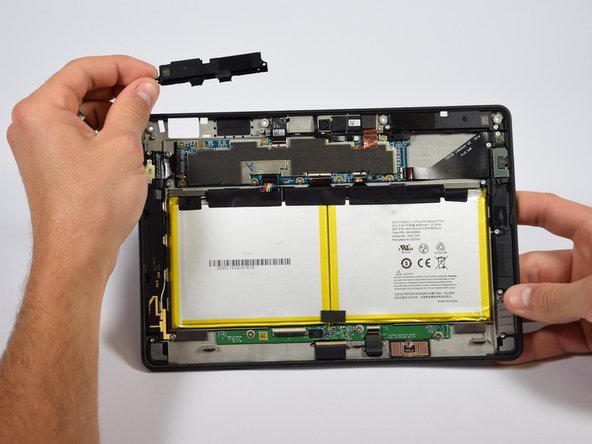

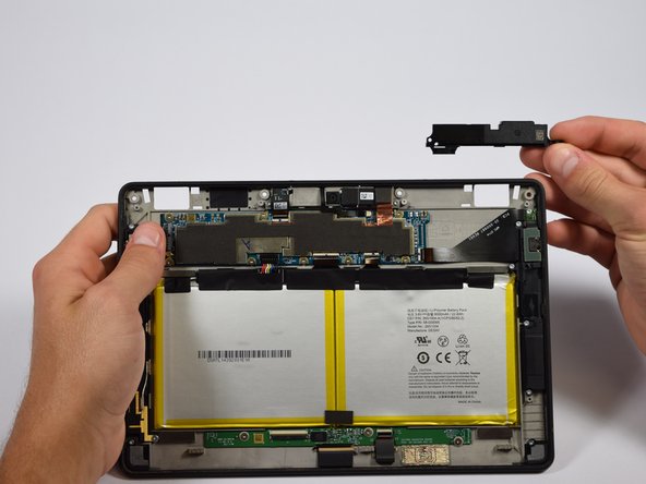

  10. Amazon Fire HDX 8.9" 4th Gen. Speaker Replacement, Speaker: crwdns2935265:010crwdnd2935265:01crwdnd2935265:03crwdne2935265:0 Amazon Fire HDX 8.9" 4th Gen. Speaker Replacement, Speaker: crwdns2935265:010crwdnd2935265:02crwdnd2935265:03crwdne2935265:0 Amazon Fire HDX 8.9" 4th Gen. Speaker Replacement, Speaker: crwdns2935265:010crwdnd2935265:03crwdnd2935265:03crwdne2935265:0
    • Using a T5 screwdriver remove the two 3 mm T5 screws for the speaker you are replacing, or if you need to replace both speakers remove all four screws.
    • The speakers have now been removed and can be replaced.
