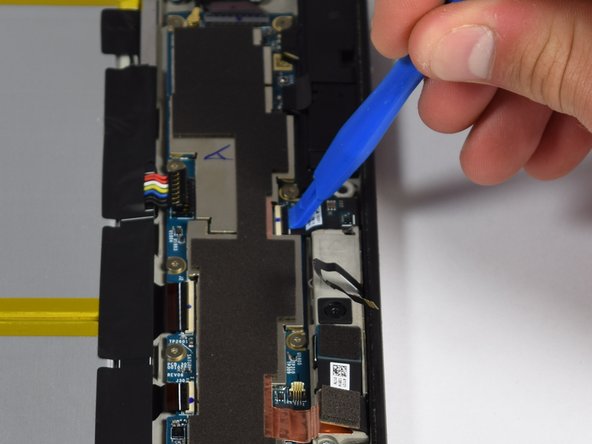

  10. Amazon Fire HDX 8.9" 4th Gen. Rear Facing Camera Replacement, Rear Facing Camera: crwdns2935265:010crwdnd2935265:01crwdnd2935265:03crwdne2935265:0 Amazon Fire HDX 8.9" 4th Gen. Rear Facing Camera Replacement, Rear Facing Camera: crwdns2935265:010crwdnd2935265:02crwdnd2935265:03crwdne2935265:0 Amazon Fire HDX 8.9" 4th Gen. Rear Facing Camera Replacement, Rear Facing Camera: crwdns2935265:010crwdnd2935265:03crwdnd2935265:03crwdne2935265:0
    • Use the spudger to lift the the small white flap holding the narrow cable down.
    • Pull the narrow flex cable up and out to detach it from the motherboard.
    • Push the band off to the side so it is out of the way.

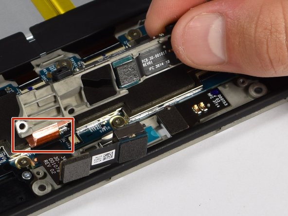

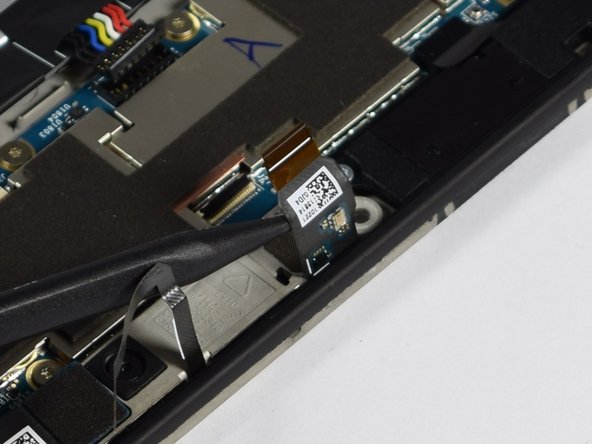

  11. Amazon Fire HDX 8.9" 4th Gen. Rear Facing Camera Replacement: crwdns2935265:011crwdnd2935265:01crwdnd2935265:03crwdne2935265:0 Amazon Fire HDX 8.9" 4th Gen. Rear Facing Camera Replacement: crwdns2935265:011crwdnd2935265:02crwdnd2935265:03crwdne2935265:0 Amazon Fire HDX 8.9" 4th Gen. Rear Facing Camera Replacement: crwdns2935265:011crwdnd2935265:03crwdnd2935265:03crwdne2935265:0
    • Now we have to detach the second flex cable connected to the camera housing.
    • Use a plastic opening tool to flip up the flap of the connector cable.
    • Once the flap is flipped up you can pull the flex cable up and out using the spudger.

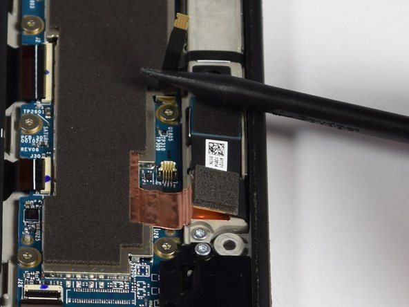

  12. Amazon Fire HDX 8.9" 4th Gen. Rear Facing Camera Replacement: crwdns2935265:012crwdnd2935265:01crwdnd2935265:01crwdne2935265:0
    • Using a T5 screwdriver remove the two 2.5 mm T5 screws securing the grey camera housing to the device.
  13. Amazon Fire HDX 8.9" 4th Gen. Rear Facing Camera Replacement: crwdns2935265:013crwdnd2935265:01crwdnd2935265:02crwdne2935265:0 Amazon Fire HDX 8.9" 4th Gen. Rear Facing Camera Replacement: crwdns2935265:013crwdnd2935265:02crwdnd2935265:02crwdne2935265:0
    • Using a spudger gently lift the camera housing from the device.
    • The housing is held in by two pins at the edge of the device so you have to pull the housing from the edge of the device inward and then up.
    • The camera housing is still attached by one cable, so do not attempt to remove yet.
    • Under the copper strip you will see one more flex cable that needs to be detached. Proceed to step 5 to remove.

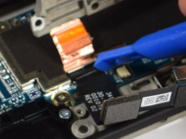

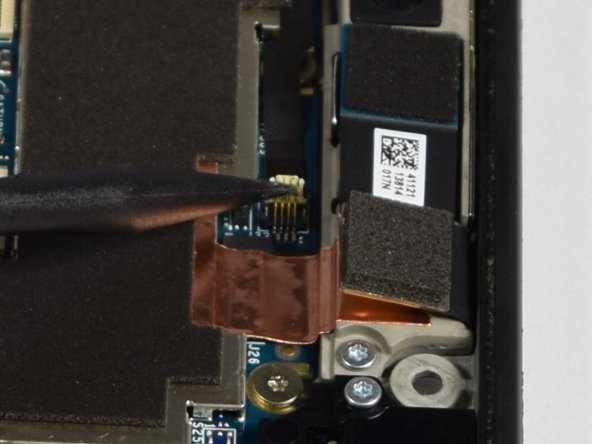

  14. Amazon Fire HDX 8.9" 4th Gen. Rear Facing Camera Replacement: crwdns2935265:014crwdnd2935265:01crwdnd2935265:02crwdne2935265:0 Amazon Fire HDX 8.9" 4th Gen. Rear Facing Camera Replacement: crwdns2935265:014crwdnd2935265:02crwdnd2935265:02crwdne2935265:0
    • Gently peel back the copper strip until you can see the flex cable connection under the black strip indicated.
    • Be careful not to tear the copper strip.
    • Use a plastic opening tool to release the flap on the plug and pull out the cable.
  15. Amazon Fire HDX 8.9" 4th Gen. Rear Facing Camera Replacement: crwdns2935265:015crwdnd2935265:01crwdnd2935265:01crwdne2935265:0
    • Once the flex cable is detached you can now remove the rear camera from the camera housing.
