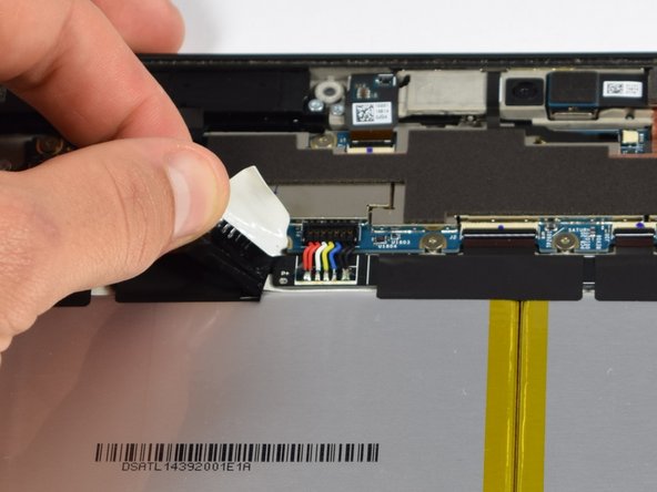

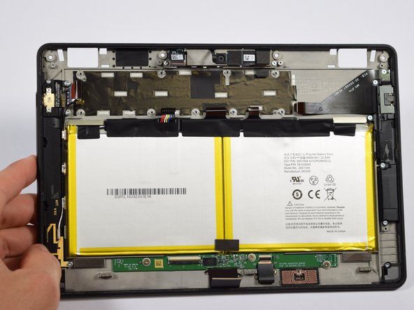

  10. Amazon Fire HDX 8.9" 4th Gen. Motherboard Replacement, Motherboard: crwdns2935265:010crwdnd2935265:01crwdnd2935265:02crwdne2935265:0 Amazon Fire HDX 8.9" 4th Gen. Motherboard Replacement, Motherboard: crwdns2935265:010crwdnd2935265:02crwdnd2935265:02crwdne2935265:0
    • Orient the device by rotating the body 90 degrees clockwise.
    • Peel off the black tape covering the main battery connection.
  11. Amazon Fire HDX 8.9" 4th Gen. Motherboard Replacement: crwdns2935265:011crwdnd2935265:01crwdnd2935265:01crwdne2935265:0
    • Use the spudger to lift up and release the battery connector.
  12. Amazon Fire HDX 8.9" 4th Gen. Motherboard Replacement: crwdns2935265:012crwdnd2935265:01crwdnd2935265:01crwdne2935265:0
    • Locate the circular gold plug to the left of the battery connection.
    • Use the spudger to lift this up from the motherboard.

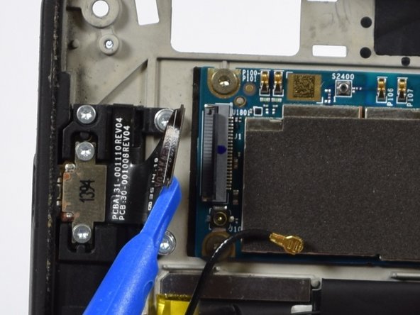

  13. Amazon Fire HDX 8.9" 4th Gen. Motherboard Replacement: crwdns2935265:013crwdnd2935265:01crwdnd2935265:02crwdne2935265:0 Amazon Fire HDX 8.9" 4th Gen. Motherboard Replacement: crwdns2935265:013crwdnd2935265:02crwdnd2935265:02crwdne2935265:0
    • Now use the plastic opening tool to lift up the black flap directly above the gold plug.
    • Pull the flex cable out.
    • This is the procedure that will be followed for all flex cables indicated.

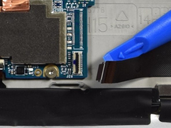

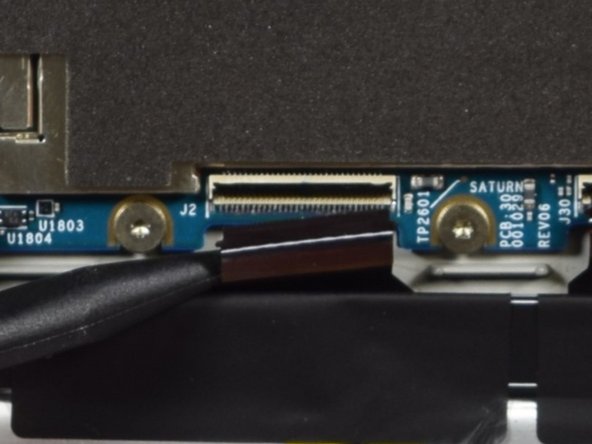

  14. Amazon Fire HDX 8.9" 4th Gen. Motherboard Replacement: crwdns2935265:014crwdnd2935265:01crwdnd2935265:02crwdne2935265:0 Amazon Fire HDX 8.9" 4th Gen. Motherboard Replacement: crwdns2935265:014crwdnd2935265:02crwdnd2935265:02crwdne2935265:0
    • Locate the third clip at the top center of the device, up from the first battery connector.
    • Follow the same procedure from the last step.
    • Lift up the black flap and pull out to release the flex cable.

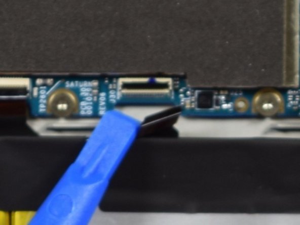

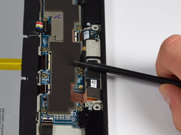

  15. Amazon Fire HDX 8.9" 4th Gen. Motherboard Replacement: crwdns2935265:015crwdnd2935265:01crwdnd2935265:03crwdne2935265:0 Amazon Fire HDX 8.9" 4th Gen. Motherboard Replacement: crwdns2935265:015crwdnd2935265:02crwdnd2935265:03crwdne2935265:0 Amazon Fire HDX 8.9" 4th Gen. Motherboard Replacement: crwdns2935265:015crwdnd2935265:03crwdnd2935265:03crwdne2935265:0
    • Locate the white tab to the right and flip it up using the plastic opening tool.
    • Rotate the device 90 degrees clockwise.
    • Use the spudger to pull up the narrow black cable out and move it out of the way to the left.

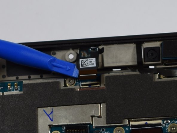

  16. Amazon Fire HDX 8.9" 4th Gen. Motherboard Replacement: crwdns2935265:016crwdnd2935265:01crwdnd2935265:02crwdne2935265:0 Amazon Fire HDX 8.9" 4th Gen. Motherboard Replacement: crwdns2935265:016crwdnd2935265:02crwdnd2935265:02crwdne2935265:0

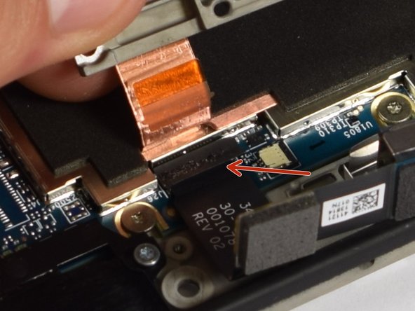

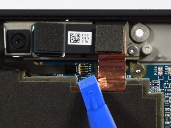

    • Now you will have to lift up the rear camera assembly that is covering the end of the copper strip.
    • Once you see the sharp corner of the copper strip, use a spudger to lift it off of the camera housing. Under the strip will be another connector cover in a small piece of black tape. Follow the steps from step 5 to remove the cable from this connection.
  17. Amazon Fire HDX 8.9" 4th Gen. Motherboard Replacement: crwdns2935265:017crwdnd2935265:01crwdnd2935265:02crwdne2935265:0 Amazon Fire HDX 8.9" 4th Gen. Motherboard Replacement: crwdns2935265:017crwdnd2935265:02crwdnd2935265:02crwdne2935265:0
