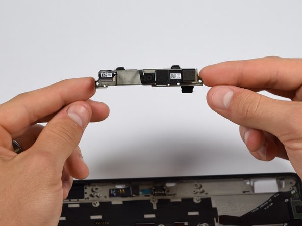

  21. Amazon Fire HDX 8.9" 4th Gen. Front Camera Replacement, Front Camera: crwdns2935265:021crwdnd2935265:01crwdnd2935265:01crwdne2935265:0
    • Remove the two 2.5 mm T5 screws.
  22. Amazon Fire HDX 8.9" 4th Gen. Front Camera Replacement: crwdns2935265:022crwdnd2935265:01crwdnd2935265:03crwdne2935265:0 Amazon Fire HDX 8.9" 4th Gen. Front Camera Replacement: crwdns2935265:022crwdnd2935265:02crwdnd2935265:03crwdne2935265:0 Amazon Fire HDX 8.9" 4th Gen. Front Camera Replacement: crwdns2935265:022crwdnd2935265:03crwdnd2935265:03crwdne2935265:0

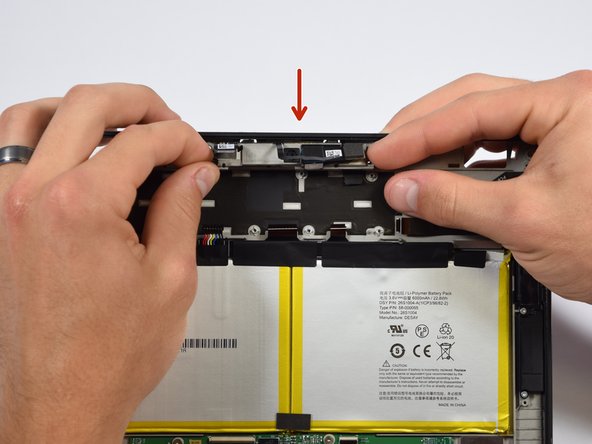

    • Using the plastic opening tool partially pry up the camera assembly.
    • Pull the assembly down to remove it from the body.
  23. Amazon Fire HDX 8.9" 4th Gen. Front Camera Replacement: crwdns2935265:023crwdnd2935265:01crwdnd2935265:03crwdne2935265:0 Amazon Fire HDX 8.9" 4th Gen. Front Camera Replacement: crwdns2935265:023crwdnd2935265:02crwdnd2935265:03crwdne2935265:0 Amazon Fire HDX 8.9" 4th Gen. Front Camera Replacement: crwdns2935265:023crwdnd2935265:03crwdnd2935265:03crwdne2935265:0

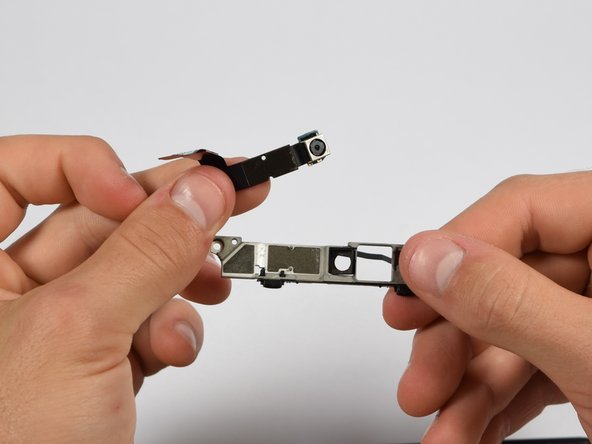

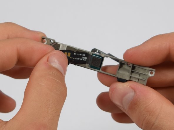

    • Flip the camera housing around to access the front facing camera.
    • Gently peel up the black cable to remove the camera from the assembly.
    • The front facing camera is now fully removed and can be replaced.
