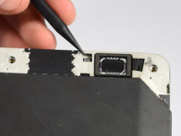

  4. Amazon Fire HDX 8.9" 4th Gen. Display Daughter Board Replacement: crwdns2935265:04crwdnd2935265:01crwdnd2935265:03crwdne2935265:0 Amazon Fire HDX 8.9" 4th Gen. Display Daughter Board Replacement: crwdns2935265:04crwdnd2935265:02crwdnd2935265:03crwdne2935265:0 Amazon Fire HDX 8.9" 4th Gen. Display Daughter Board Replacement: crwdns2935265:04crwdnd2935265:03crwdnd2935265:03crwdne2935265:0

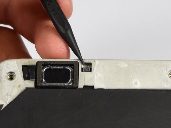

    • Release the two clear plastic clips at the top of the device near the speaker using the spudger.
    • Simply push down the clip with the tip of the spudger.
    • Push lightly to ensure that the clips aren't damaged.

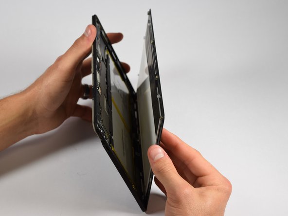

    • Use a plastic opening tool to wedge between the screen and the device, while simultaneously holding the clip open from step 4.
    • Pry the screen very gently to avoid cracking the glass
    • Start to remove the screen from where the black plastic trim was removed and work the tool around the sides of the device. You will here small pops from the clips on the sides being released.
    • The Amazon Fire can now be opened with the two flex cables at the base still connected

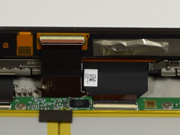

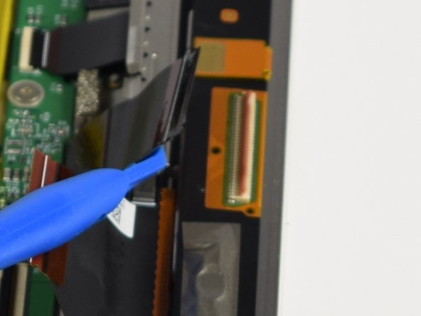

  6. Amazon Fire HDX 8.9" 4th Gen. Display Daughter Board Replacement: crwdns2935265:06crwdnd2935265:01crwdnd2935265:02crwdne2935265:0 Amazon Fire HDX 8.9" 4th Gen. Display Daughter Board Replacement: crwdns2935265:06crwdnd2935265:02crwdnd2935265:02crwdne2935265:0

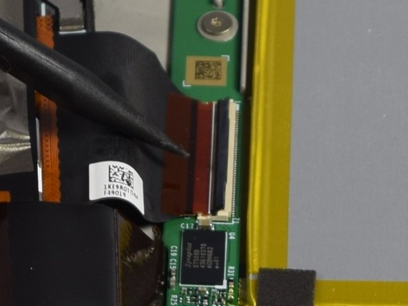

    • Now we have to remove the two flex cables attached to both the screen assembly and body of the device.
    • The cable addressed in step 8 is highlighted in orange.

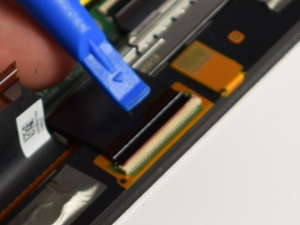

  7. Amazon Fire HDX 8.9" 4th Gen. Display Daughter Board Replacement: crwdns2935265:07crwdnd2935265:01crwdnd2935265:03crwdne2935265:0 Amazon Fire HDX 8.9" 4th Gen. Display Daughter Board Replacement: crwdns2935265:07crwdnd2935265:02crwdnd2935265:03crwdne2935265:0 Amazon Fire HDX 8.9" 4th Gen. Display Daughter Board Replacement: crwdns2935265:07crwdnd2935265:03crwdnd2935265:03crwdne2935265:0
    • First turn the device 90 degrees counterclockwise.
    • Wedge a spudger or plastic opening tool under the black flap of the larger connector and lift up.
    • Pull the belt out of the connector and lift it up.
  8. Amazon Fire HDX 8.9" 4th Gen. Display Daughter Board Replacement: crwdns2935265:08crwdnd2935265:01crwdnd2935265:03crwdne2935265:0 Amazon Fire HDX 8.9" 4th Gen. Display Daughter Board Replacement: crwdns2935265:08crwdnd2935265:02crwdnd2935265:03crwdne2935265:0 Amazon Fire HDX 8.9" 4th Gen. Display Daughter Board Replacement: crwdns2935265:08crwdnd2935265:03crwdnd2935265:03crwdne2935265:0
    • Turn the device 180 degrees.
    • Repeat step 7 for the smaller flex cable connection.
  9. Amazon Fire HDX 8.9" 4th Gen. Display Daughter Board Replacement: crwdns2935265:09crwdnd2935265:01crwdnd2935265:01crwdne2935265:0

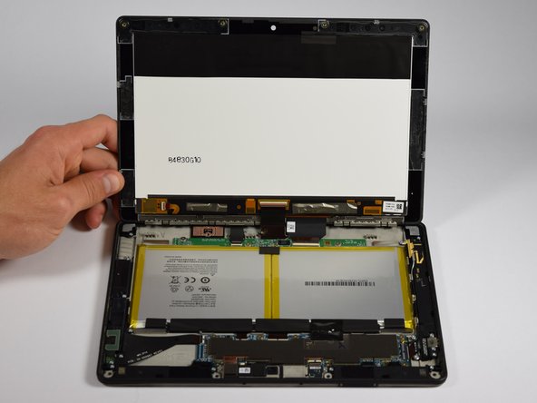

    • Your screen assembly has now been removed and can be replaced.

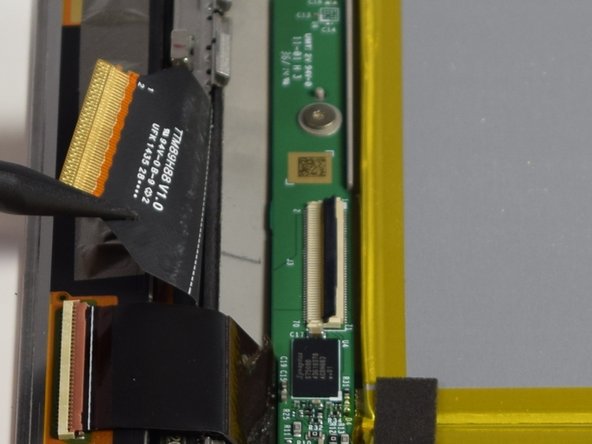

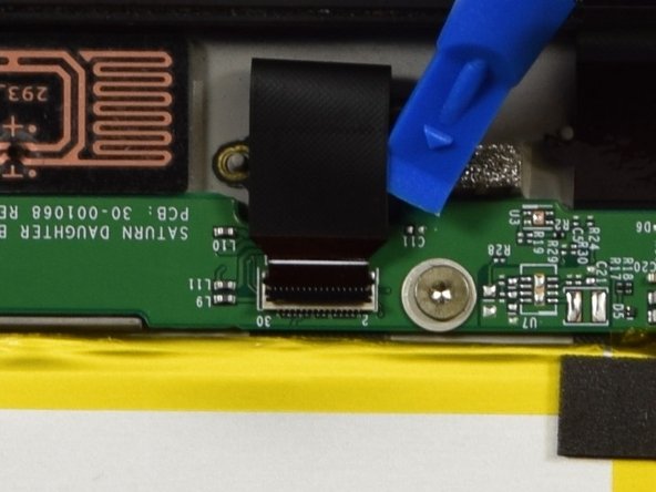

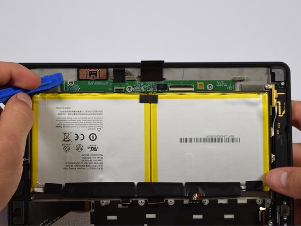

  10. Amazon Fire HDX 8.9" 4th Gen. Display Daughter Board Replacement, Display Daughterboard: crwdns2935265:010crwdnd2935265:01crwdnd2935265:01crwdne2935265:0
    • We can now remove the display daughterboard.

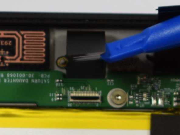

    • Start by disconnecting the lone flex cable still connected to the daughterboard.
  11. Amazon Fire HDX 8.9" 4th Gen. Display Daughter Board Replacement: crwdns2935265:011crwdnd2935265:01crwdnd2935265:03crwdne2935265:0 Amazon Fire HDX 8.9" 4th Gen. Display Daughter Board Replacement: crwdns2935265:011crwdnd2935265:02crwdnd2935265:03crwdne2935265:0 Amazon Fire HDX 8.9" 4th Gen. Display Daughter Board Replacement: crwdns2935265:011crwdnd2935265:03crwdnd2935265:03crwdne2935265:0
    • Use a plastic opening tool to flip the black tab up on the connector.
    • Pull the flex cable out and up.
  12. Amazon Fire HDX 8.9" 4th Gen. Display Daughter Board Replacement: crwdns2935265:012crwdnd2935265:01crwdnd2935265:03crwdne2935265:0 Amazon Fire HDX 8.9" 4th Gen. Display Daughter Board Replacement: crwdns2935265:012crwdnd2935265:02crwdnd2935265:03crwdne2935265:0 Amazon Fire HDX 8.9" 4th Gen. Display Daughter Board Replacement: crwdns2935265:012crwdnd2935265:03crwdnd2935265:03crwdne2935265:0
    • With a T5 screw driver remove the three 2 mm T5 screws securing the daughterboard to the device.
    • Use a plastic opening tool to lift up the daughterboard from the device.
    • The daughterboard has now been completely removed, and can be replaced.
