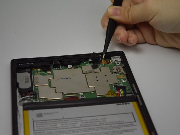

  5. Amazon Fire HD 8 Rear-facing Camera Replacement, Rear-facing Camera: crwdns2935265:05crwdnd2935265:01crwdnd2935265:02crwdne2935265:0 Amazon Fire HD 8 Rear-facing Camera Replacement, Rear-facing Camera: crwdns2935265:05crwdnd2935265:02crwdnd2935265:02crwdne2935265:0
    • Pop the camera out of the rear-facing camera casing by carefully pulling the orange cable with the tweezers.

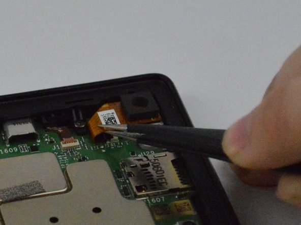

  6. Amazon Fire HD 8 Rear-facing Camera Replacement: crwdns2935265:06crwdnd2935265:01crwdnd2935265:02crwdne2935265:0 Amazon Fire HD 8 Rear-facing Camera Replacement: crwdns2935265:06crwdnd2935265:02crwdnd2935265:02crwdne2935265:0
    • Flip up the tab on the ZIF connector at the end of the ribbon cable.
    • Grasp the underside of the orange cable with the tweezers and gently slide the camera out of the connector.
