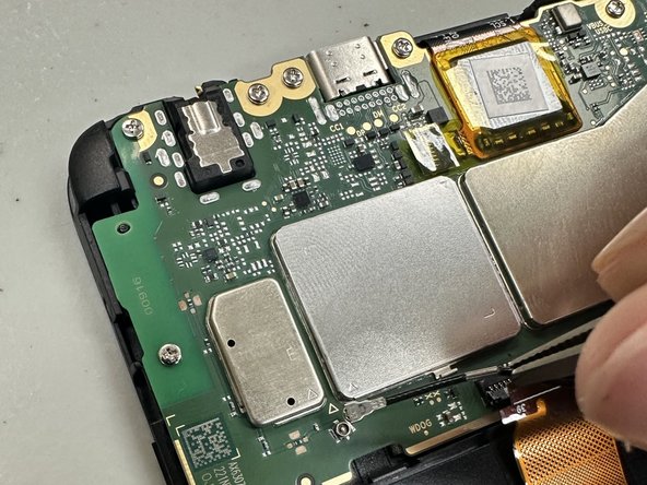

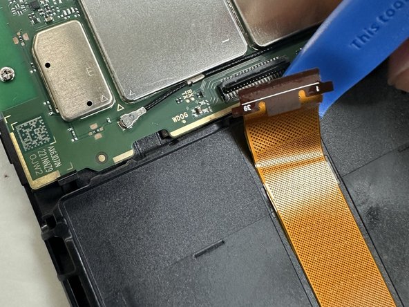

    • Lift the black ZIF locking flap.
    • Disconnect the orange ribbon cable.
  8. Amazon Fire HD 8 Plus 12th Gen USB Port Replacement: crwdns2935265:08crwdnd2935265:01crwdnd2935265:03crwdne2935265:0 Amazon Fire HD 8 Plus 12th Gen USB Port Replacement: crwdns2935265:08crwdnd2935265:02crwdnd2935265:03crwdne2935265:0 Amazon Fire HD 8 Plus 12th Gen USB Port Replacement: crwdns2935265:08crwdnd2935265:03crwdnd2935265:03crwdne2935265:0

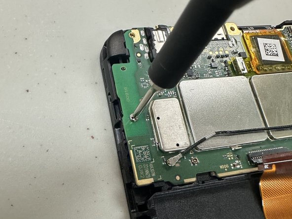

    • Remove all of the Phillips screws that secure the motherboard.
  9. Amazon Fire HD 8 Plus 12th Gen USB Port Replacement: crwdns2935265:09crwdnd2935265:01crwdnd2935265:01crwdne2935265:0
    • Once the motherboard is fully disconnected from the device lift the motherboard out of the chassis with an opening tool.
