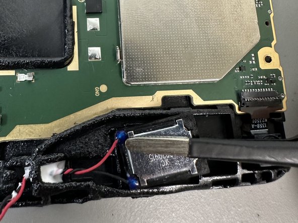

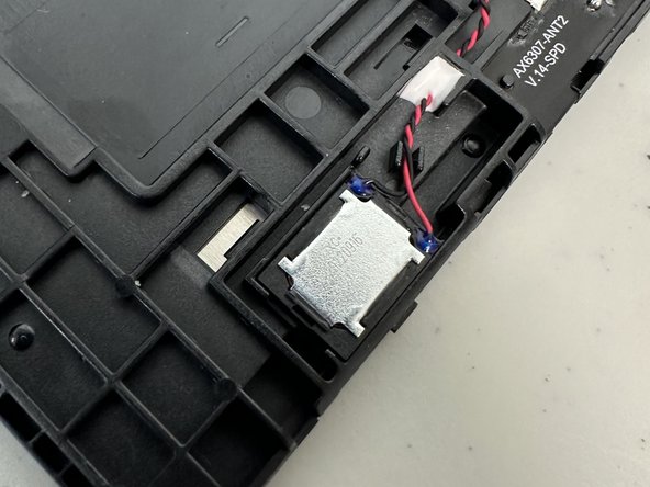

  5. Amazon Fire HD 8 Plus 12th Gen Speakers Replacement, Speakers: crwdns2935265:05crwdnd2935265:01crwdnd2935265:03crwdne2935265:0 Amazon Fire HD 8 Plus 12th Gen Speakers Replacement, Speakers: crwdns2935265:05crwdnd2935265:02crwdnd2935265:03crwdne2935265:0 Amazon Fire HD 8 Plus 12th Gen Speakers Replacement, Speakers: crwdns2935265:05crwdnd2935265:03crwdnd2935265:03crwdne2935265:0
    • Desolder the speaker motherboard connections.
    • Soldering can cause burns and fires. Always solder in a well-ventilated workspace.
    • Lift the speaker up and out of the chassis.
