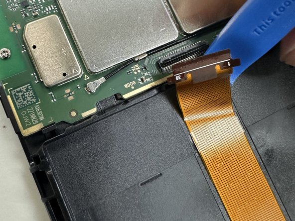

  3. Amazon Fire HD 8 Plus 12th Gen Motherboard Replacement, Amazon Fire HD 8 Plus 12th Gen Battery Disconnection: crwdns2935265:03crwdnd2935265:01crwdnd2935265:01crwdne2935265:0
    • Use an opening tool to lift the battery connector until it disconnects.

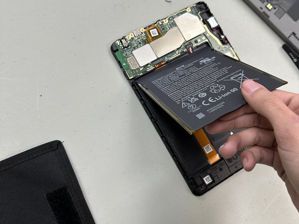

  4. Amazon Fire HD 8 Plus 12th Gen Motherboard Replacement, Battery: crwdns2935265:04crwdnd2935265:01crwdnd2935265:01crwdne2935265:0
    • Gently and slowly grip and pull the three white adhesive tabs that secure the battery until they fully release.
    • The adhesives are marked with a black flap with a white adhesive. You will know it has been successfully removed when you can move the battery around.

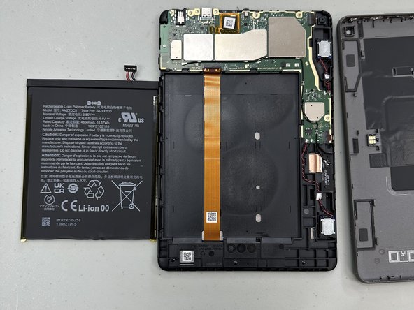

  5. Amazon Fire HD 8 Plus 12th Gen Motherboard Replacement: crwdns2935265:05crwdnd2935265:01crwdnd2935265:03crwdne2935265:0 Amazon Fire HD 8 Plus 12th Gen Motherboard Replacement: crwdns2935265:05crwdnd2935265:02crwdnd2935265:03crwdne2935265:0 Amazon Fire HD 8 Plus 12th Gen Motherboard Replacement: crwdns2935265:05crwdnd2935265:03crwdnd2935265:03crwdne2935265:0
    • Gently pry around the entire perimeter of the battery with an opening tool until the adhesive releases.
    • Remove the battery.
    • Take care not to bend or puncture the battery while prying the battery.
    • Clean under the old battery and insert a new battery with adhesive to ensure the battery stays in place.

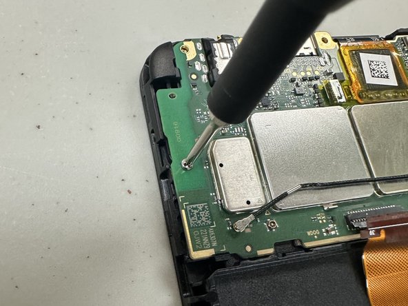

  6. Amazon Fire HD 8 Plus 12th Gen Motherboard Replacement, Motherboard: crwdns2935265:06crwdnd2935265:01crwdnd2935265:02crwdne2935265:0 Amazon Fire HD 8 Plus 12th Gen Motherboard Replacement, Motherboard: crwdns2935265:06crwdnd2935265:02crwdnd2935265:02crwdne2935265:0
    • Lift the black ZIF locking flap.
    • Disconnect the ribbon cable.

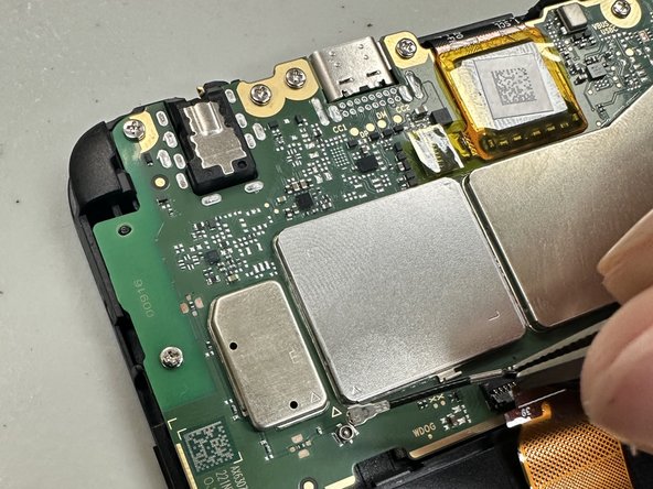

  7. Amazon Fire HD 8 Plus 12th Gen Motherboard Replacement: crwdns2935265:07crwdnd2935265:01crwdnd2935265:03crwdne2935265:0 Amazon Fire HD 8 Plus 12th Gen Motherboard Replacement: crwdns2935265:07crwdnd2935265:02crwdnd2935265:03crwdne2935265:0 Amazon Fire HD 8 Plus 12th Gen Motherboard Replacement: crwdns2935265:07crwdnd2935265:03crwdnd2935265:03crwdne2935265:0

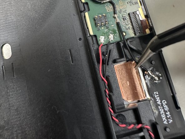

    • Remove all of the Phillips screws that secure the motherboard.

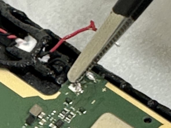

  8. Amazon Fire HD 8 Plus 12th Gen Motherboard Replacement: crwdns2935265:08crwdnd2935265:01crwdnd2935265:03crwdne2935265:0 Amazon Fire HD 8 Plus 12th Gen Motherboard Replacement: crwdns2935265:08crwdnd2935265:02crwdnd2935265:03crwdne2935265:0 Amazon Fire HD 8 Plus 12th Gen Motherboard Replacement: crwdns2935265:08crwdnd2935265:03crwdnd2935265:03crwdne2935265:0
    • Desolder all of the soldered motherboard connections.
    • Soldering can cause fires and burns. Always solder in a well-ventilated workspace.
  9. Amazon Fire HD 8 Plus 12th Gen Motherboard Replacement: crwdns2935265:09crwdnd2935265:01crwdnd2935265:01crwdne2935265:0
    • Lift the motherboard up and out of the chassis.
