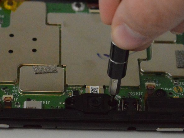

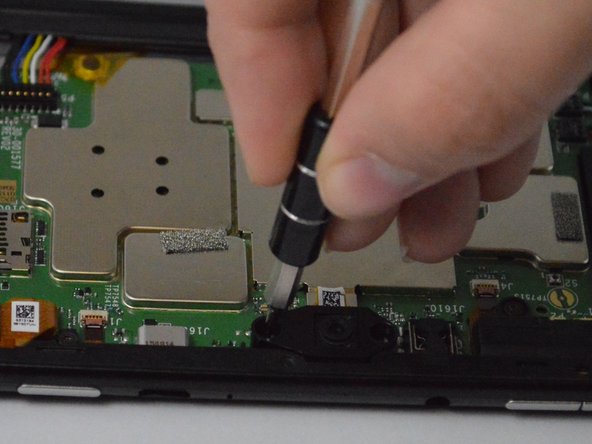

  5. Amazon Fire HD 8 Front Camera Replacement, Front Camera: crwdns2935265:05crwdnd2935265:01crwdnd2935265:03crwdne2935265:0 Amazon Fire HD 8 Front Camera Replacement, Front Camera: crwdns2935265:05crwdnd2935265:02crwdnd2935265:03crwdne2935265:0 Amazon Fire HD 8 Front Camera Replacement, Front Camera: crwdns2935265:05crwdnd2935265:03crwdnd2935265:03crwdne2935265:0
    • Using a T4 screwdriver, remove the two screws situated on the left and right side of the camera.
    • The gasket may pop out, but it can easily be put back in.

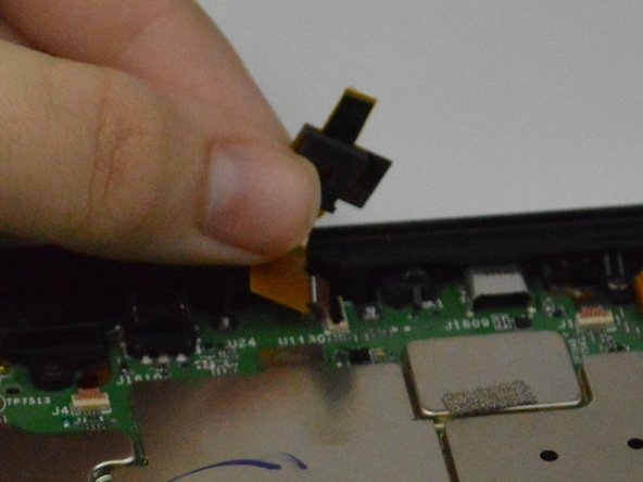

  6. Amazon Fire HD 8 Front Camera Replacement: crwdns2935265:06crwdnd2935265:01crwdnd2935265:02crwdne2935265:0 Amazon Fire HD 8 Front Camera Replacement: crwdns2935265:06crwdnd2935265:02crwdnd2935265:02crwdne2935265:0
    • Using tweezers, gently remove the white tape with the QR code.
    • Fold the camera back and use tweezers to gently remove the orange tab.
