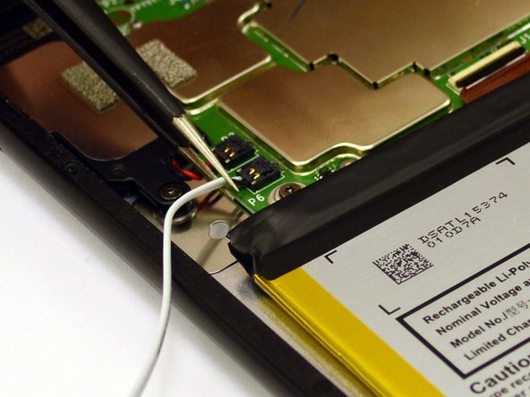

  8. Amazon Fire HD 8 Bottom Speaker Replacement: crwdns2935265:08crwdnd2935265:01crwdnd2935265:02crwdne2935265:0 Amazon Fire HD 8 Bottom Speaker Replacement: crwdns2935265:08crwdnd2935265:02crwdnd2935265:02crwdne2935265:0
    • Set aside the black speaker and follow the white wire to its connection on the upper left side of the motherboard.
    • Using tweezers, gently pry the black clip upward from the board.
