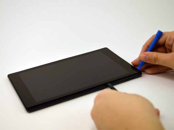

    • Heat the edges of the screen with a heat gun on the lowest setting by using sweeping motions from about 8-10 inches away.
    • Make sure you use sweeping motions with the heat gun, instead of hovering over one area.
  2. Amazon Fire HD 8 Battery Replacement: crwdns2935265:02crwdnd2935265:01crwdnd2935265:01crwdne2935265:0
    • After 1-2 minutes, use a plastic opening tool to pry the screen loose. Start at the top right corner and gently pry the screen from the device.
    • Be careful not to bend the screen by pushing it too far from the rest of the device.
  3. Amazon Fire HD 8 Battery Replacement: crwdns2935265:03crwdnd2935265:01crwdnd2935265:03crwdne2935265:0 Amazon Fire HD 8 Battery Replacement: crwdns2935265:03crwdnd2935265:02crwdnd2935265:03crwdne2935265:0 Amazon Fire HD 8 Battery Replacement: crwdns2935265:03crwdnd2935265:03crwdnd2935265:03crwdne2935265:0
    • Slide a plastic opening tool and spudger along the underside of the screen using enough force to peel the screen and the adhesive strip from the other half of the device.
    • Be mindful of the orange cable connecting the screen to the mid-bottom of the device.
  4. Amazon Fire HD 8 Battery Replacement: crwdns2935265:04crwdnd2935265:01crwdnd2935265:03crwdne2935265:0 Amazon Fire HD 8 Battery Replacement: crwdns2935265:04crwdnd2935265:02crwdnd2935265:03crwdne2935265:0 Amazon Fire HD 8 Battery Replacement: crwdns2935265:04crwdnd2935265:03crwdnd2935265:03crwdne2935265:0
    • To remove the screen from the device, use tweezers to gently pull the orange cable from its connection to the screen.

  5. Amazon Fire HD 8 Battery Replacement, Battery: crwdns2935265:05crwdnd2935265:01crwdnd2935265:03crwdne2935265:0 Amazon Fire HD 8 Battery Replacement, Battery: crwdns2935265:05crwdnd2935265:02crwdnd2935265:03crwdne2935265:0 Amazon Fire HD 8 Battery Replacement, Battery: crwdns2935265:05crwdnd2935265:03crwdnd2935265:03crwdne2935265:0
    • Be careful not to bend or puncture the battery.
    • Lift the wired connector on the top-right of the battery with just enough pressure to disconnect it from the connector.
  6. Amazon Fire HD 8 Battery Replacement: crwdns2935265:06crwdnd2935265:01crwdnd2935265:02crwdne2935265:0 Amazon Fire HD 8 Battery Replacement: crwdns2935265:06crwdnd2935265:02crwdnd2935265:02crwdne2935265:0
    • There are four black tabs on the bottom of the battery that run strips of adhesive beneath the battery.
    • Pull on each tab individually until all four strips are removed. Once the last adhesive strip is removed, the battery will pop out.
