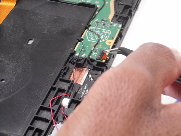

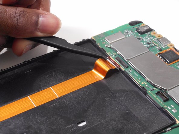

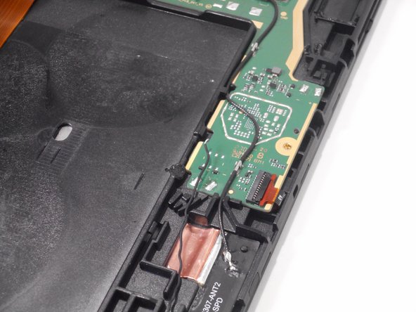

    1. Amazon Fire HD 8 12th Gen USB Port Replacement, USB Port: crwdns2935265:06crwdnd2935265:01crwdnd2935265:03crwdne2935265:0 Amazon Fire HD 8 12th Gen USB Port Replacement, USB Port: crwdns2935265:06crwdnd2935265:02crwdnd2935265:03crwdne2935265:0 Amazon Fire HD 8 12th Gen USB Port Replacement, USB Port: crwdns2935265:06crwdnd2935265:03crwdnd2935265:03crwdne2935265:0
      • Remove the yellow-orange strip from the back of the device by disconnecting it from the motherboard.
      • Disconnect the black wiring on the motherboard.

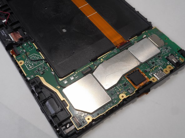

    2. Amazon Fire HD 8 12th Gen USB Port Replacement: crwdns2935265:07crwdnd2935265:01crwdnd2935265:03crwdne2935265:0 Amazon Fire HD 8 12th Gen USB Port Replacement: crwdns2935265:07crwdnd2935265:02crwdnd2935265:03crwdne2935265:0 Amazon Fire HD 8 12th Gen USB Port Replacement: crwdns2935265:07crwdnd2935265:03crwdnd2935265:03crwdne2935265:0
      • Unscrew the motherboard from the device. 7 Screws total should be unscrewed. (0+ screwhead used from iFixit tool kit. 2.5 mm screw)
      • Disconnect the front camera from the motherboard by disconnecting the yellow orange strip.

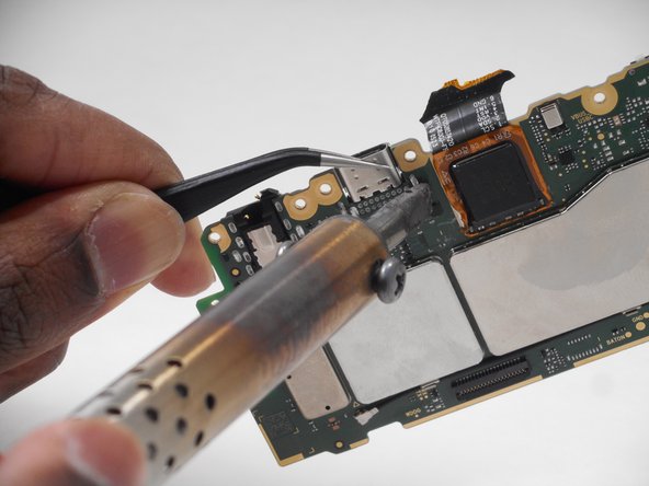

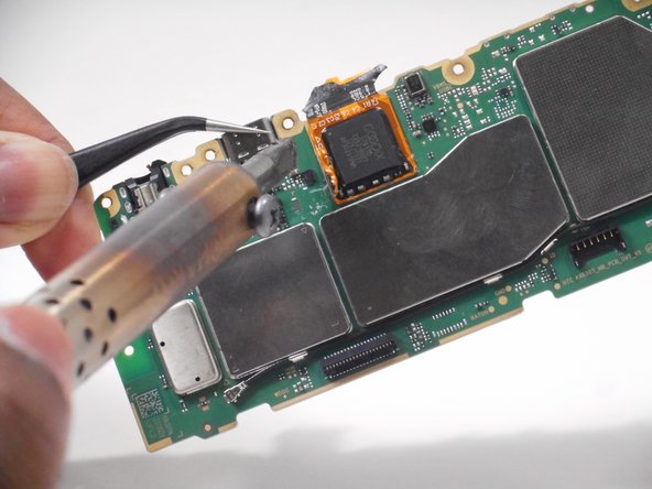

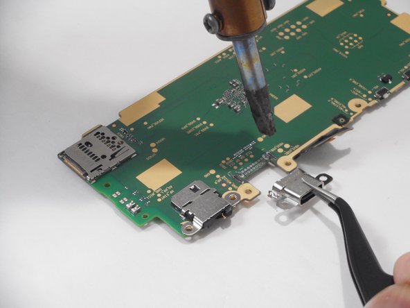

    3. Amazon Fire HD 8 12th Gen USB Port Replacement: crwdns2935265:08crwdnd2935265:01crwdnd2935265:03crwdne2935265:0 Amazon Fire HD 8 12th Gen USB Port Replacement: crwdns2935265:08crwdnd2935265:02crwdnd2935265:03crwdne2935265:0 Amazon Fire HD 8 12th Gen USB Port Replacement: crwdns2935265:08crwdnd2935265:03crwdnd2935265:03crwdne2935265:0
      • Once the motherboard is fully disconnected from the device, lift and remove the motherboard from the device using an opening tool.
      • Heat up the motherboard area under the usb/charging ports using a soldering iron or hair dryer. (Connection ports)
      • Be careful of the hot metal and hot tools being used.

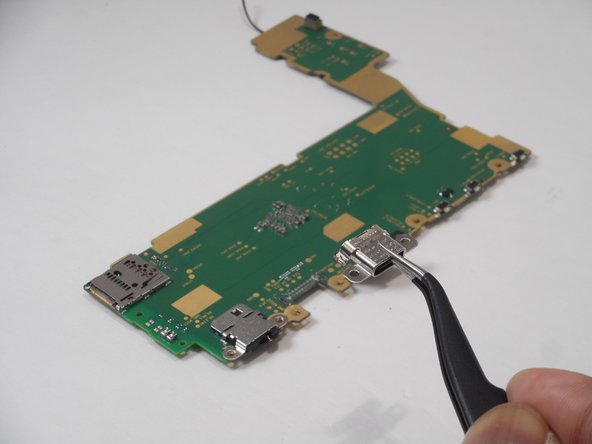

    4. Amazon Fire HD 8 12th Gen USB Port Replacement: crwdns2935265:09crwdnd2935265:01crwdnd2935265:03crwdne2935265:0 Amazon Fire HD 8 12th Gen USB Port Replacement: crwdns2935265:09crwdnd2935265:02crwdnd2935265:03crwdne2935265:0 Amazon Fire HD 8 12th Gen USB Port Replacement: crwdns2935265:09crwdnd2935265:03crwdnd2935265:03crwdne2935265:0
      • Once area is heated, gently pull the charging port while still heating the connection ports.
      • The charging port should come out its position and be ready to be replaced.
      • Be careful of hot metal and hot tools.
