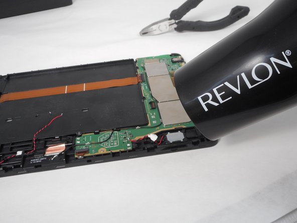

    • Disconnect the red and black wires connected to the motherboard.
  4. Amazon Fire HD 8 12th Gen Speakers Replacement: crwdns2935265:04crwdnd2935265:01crwdnd2935265:03crwdne2935265:0 Amazon Fire HD 8 12th Gen Speakers Replacement: crwdns2935265:04crwdnd2935265:02crwdnd2935265:03crwdne2935265:0 Amazon Fire HD 8 12th Gen Speakers Replacement: crwdns2935265:04crwdnd2935265:03crwdnd2935265:03crwdne2935265:0
    • Heat glue up to loosen the black and red wires, then lift and remove black and red wires.
    • Be careful of hot metals/parts and hot tools.

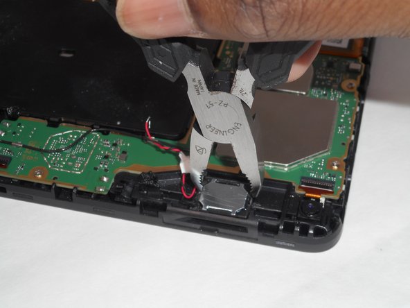

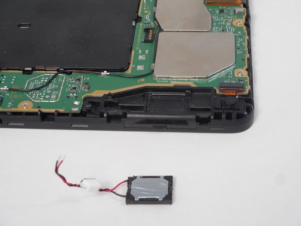

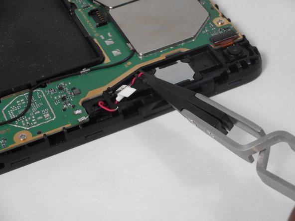

  5. Amazon Fire HD 8 12th Gen Speakers Replacement: crwdns2935265:05crwdnd2935265:01crwdnd2935265:03crwdne2935265:0 Amazon Fire HD 8 12th Gen Speakers Replacement: crwdns2935265:05crwdnd2935265:02crwdnd2935265:03crwdne2935265:0 Amazon Fire HD 8 12th Gen Speakers Replacement: crwdns2935265:05crwdnd2935265:03crwdnd2935265:03crwdne2935265:0
    • Get metal speaker parts hot as well and lift the metal speaker up.
    • Do this for the other set of speakers and repeat the steps again.
    • Be careful of hot tools and hot parts.
