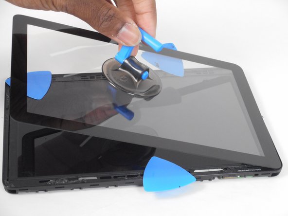

      • Start off by heating the edges of the screen to melt the adhesive.
      • Insert the opening picks between the screen and device.
    2. Amazon Fire HD 8 12th Gen Screen Replacement: crwdns2935265:07crwdnd2935265:01crwdnd2935265:03crwdne2935265:0 Amazon Fire HD 8 12th Gen Screen Replacement: crwdns2935265:07crwdnd2935265:02crwdnd2935265:03crwdne2935265:0 Amazon Fire HD 8 12th Gen Screen Replacement: crwdns2935265:07crwdnd2935265:03crwdnd2935265:03crwdne2935265:0
      • Slide the opening pick in between the screen and device, prying it just above the device.
      • Place the suction on the screen
    3. Amazon Fire HD 8 12th Gen Screen Replacement: crwdns2935265:08crwdnd2935265:01crwdnd2935265:03crwdne2935265:0 Amazon Fire HD 8 12th Gen Screen Replacement: crwdns2935265:08crwdnd2935265:02crwdnd2935265:03crwdne2935265:0 Amazon Fire HD 8 12th Gen Screen Replacement: crwdns2935265:08crwdnd2935265:03crwdnd2935265:03crwdne2935265:0
      • Gently pull the screen off using the suction and opening tool.

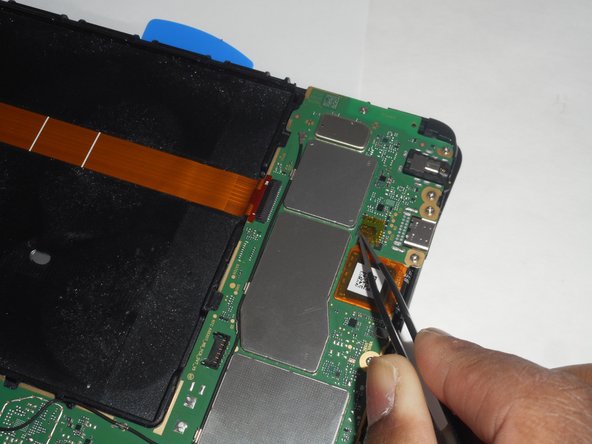

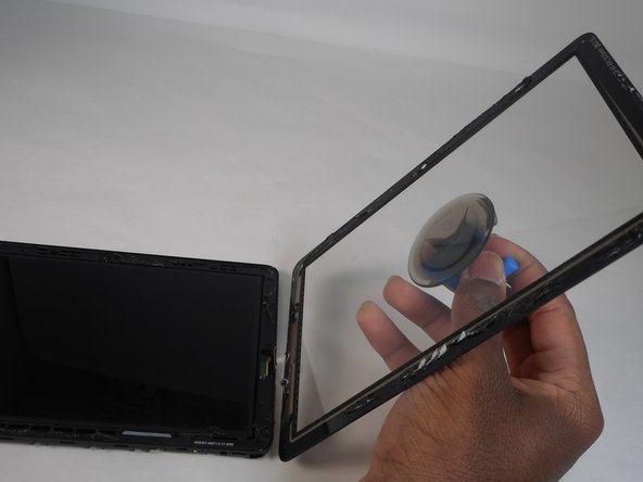

    4. Amazon Fire HD 8 12th Gen Screen Replacement: crwdns2935265:09crwdnd2935265:01crwdnd2935265:03crwdne2935265:0 Amazon Fire HD 8 12th Gen Screen Replacement: crwdns2935265:09crwdnd2935265:02crwdnd2935265:03crwdne2935265:0 Amazon Fire HD 8 12th Gen Screen Replacement: crwdns2935265:09crwdnd2935265:03crwdnd2935265:03crwdne2935265:0
      • Heat up the little black square with yellow orange tape around it on the back of the device, atop the motherboard.
      • Once heated, remove the little black square using tweezers. Unhooking the screen from the screen.
      • Pulling the suction cup, fully remove the screen from the device.
