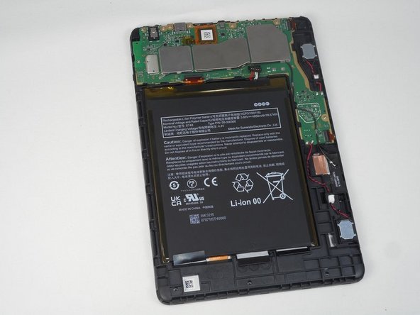

      • Remove the device from any electrical source and make sure it is powered off.
      • Put picks around the corner and move them along the edge to pry the case off.
      • Once there is separation between the case and the screen, place a pick in between the screen and on the corner of the back case.

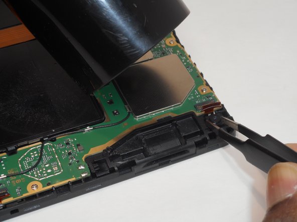

      • With the corners lifted, take the opening tool and pry each corner off.
      • Repeat this for the corner diagonal from the initial corner.
      • Once both corners are pried off, gently take the back case off the device.

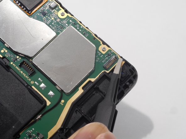

      • Using the iFixit opening tool, disconnect the battery from the circuit board.
    2. Amazon Fire HD 8 12th Gen Camera Replacement: crwdns2935265:04crwdnd2935265:01crwdnd2935265:03crwdne2935265:0 Amazon Fire HD 8 12th Gen Camera Replacement: crwdns2935265:04crwdnd2935265:02crwdnd2935265:03crwdne2935265:0 Amazon Fire HD 8 12th Gen Camera Replacement: crwdns2935265:04crwdnd2935265:03crwdnd2935265:03crwdne2935265:0
      • Disconnect the camera from the motherboard by unplugging the orange wiring.

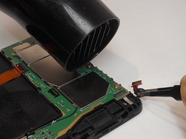

      • Heat the area of the back camera up loosening the glue holding it in place.
      • Be careful when using hot tools and removing hot parts.

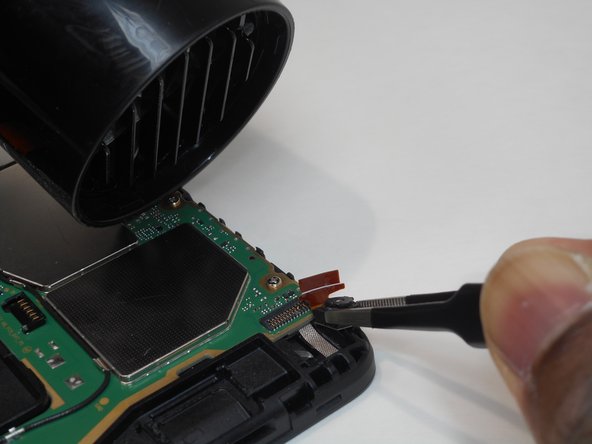

      • Once disconnected from the motherboard and heated up, use tweezers to remove the old camera.
