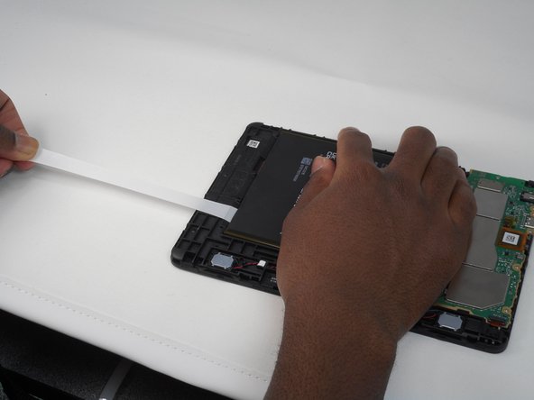

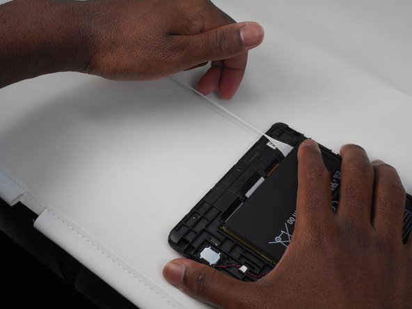

    • Slowly and gently, pull and remove the 3 adhesives under the old battery.
    • Remove all 3 by pulling the adhesive, signified by a black flap with white adhesive. You will know it is removed when the adhesive has come out from under the battery and you are now able to move the battery.
  5. Amazon Fire HD 8 12th Gen Battery Replacement: crwdns2935265:05crwdnd2935265:01crwdnd2935265:03crwdne2935265:0 Amazon Fire HD 8 12th Gen Battery Replacement: crwdns2935265:05crwdnd2935265:02crwdnd2935265:03crwdne2935265:0 Amazon Fire HD 8 12th Gen Battery Replacement: crwdns2935265:05crwdnd2935265:03crwdnd2935265:03crwdne2935265:0
    • Remove the old battery from the device using the opening tool.
    • If necessary, clean under your old battery and then insert the new battery with new adhesive to ensure the battery stays in place.
