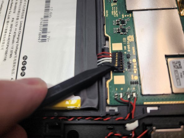

    3. Amazon Fire HD 8 (8th Gen) Digitizer Replacement, Disconnect the Battery: crwdns2935265:03crwdnd2935265:01crwdnd2935265:03crwdne2935265:0 Amazon Fire HD 8 (8th Gen) Digitizer Replacement, Disconnect the Battery: crwdns2935265:03crwdnd2935265:02crwdnd2935265:03crwdne2935265:0 Amazon Fire HD 8 (8th Gen) Digitizer Replacement, Disconnect the Battery: crwdns2935265:03crwdnd2935265:03crwdnd2935265:03crwdne2935265:0
      • Using the tip of your Spudger, release the battery connector.
      • Bend the battery connector up and out of the way to ensure it will not make contact with the circuit again. The wires are stiff and will hold the connector out of the way.

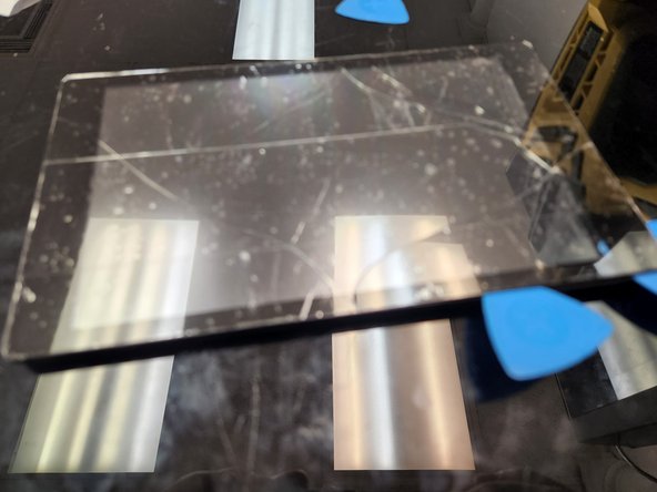

    4. Amazon Fire HD 8 (8th Gen) Digitizer Replacement, Apply Heat to the Display: crwdns2935265:04crwdnd2935265:01crwdnd2935265:01crwdne2935265:0
      • If your glass is cracked, before removing use some tape to hold it together. If it shatters or breaks further, this will prevent glass shards from causing injury.
      • Using your heat gun, heat the edges of the glass to soften the adhesive. Start at the top right corner and work your around.
      • An iOpener or a heating pad will work just as well as a heat gun.
      • Follow the same path as with the case, working your way down to the bottom, around the corners, and back up.
      • If at any time the adhesive becomes hard, stop and apply more heat. Do not attempt to cut the adhesive if it is too hard.
      • Throughout the next steps, take extra care not to insert your Opening Pick too far. The LCD underneath is delicate and can be scratched even by the plastic pick as you're cutting the adhesive away.
    5. Amazon Fire HD 8 (8th Gen) Digitizer Replacement, Separate the Digitizer (1): crwdns2935265:05crwdnd2935265:01crwdnd2935265:03crwdne2935265:0 Amazon Fire HD 8 (8th Gen) Digitizer Replacement, Separate the Digitizer (1): crwdns2935265:05crwdnd2935265:02crwdnd2935265:03crwdne2935265:0 Amazon Fire HD 8 (8th Gen) Digitizer Replacement, Separate the Digitizer (1): crwdns2935265:05crwdnd2935265:03crwdnd2935265:03crwdne2935265:0
      • After heating, use a Suction Handle to lift up on the glass.
      • Insert an Opening Pick on the top edge near the right corner.
      • Now and throughout the next steps, take extra care not to insert your Opening Picks beyond the black border on the digitizer, or you may cause irreparable damage to the LCD.
      • After ensuring the Opening Pick is inserted, remove the Suction Handle.
      • Leave an Opening Pick in the top right corner to prevent the adhesive from resealing.
      • Using a second opening pick, slide down the right side, cutting through the adhesive, until you reach the bottom right corner. Leave the second pick in the second corner.

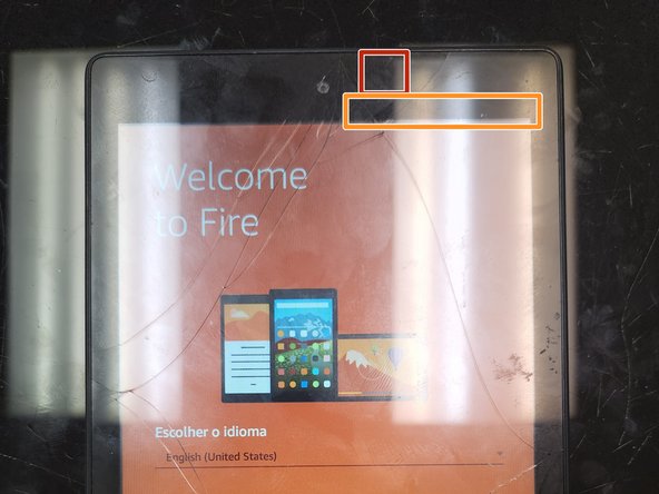

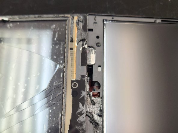

    9. Amazon Fire HD 8 (8th Gen) Digitizer Replacement, Digitizer Cautions: crwdns2935265:09crwdnd2935265:01crwdnd2935265:03crwdne2935265:0 Amazon Fire HD 8 (8th Gen) Digitizer Replacement, Digitizer Cautions: crwdns2935265:09crwdnd2935265:02crwdnd2935265:03crwdne2935265:0 Amazon Fire HD 8 (8th Gen) Digitizer Replacement, Digitizer Cautions: crwdns2935265:09crwdnd2935265:03crwdnd2935265:03crwdne2935265:0
      • Note the placement of the ribbon cable (red).
      • Note the area where the digitizer leads connect to the ribbon cable (orange).
      • The third photo shows where these are from the outside, so you know where to take extra care before you get the digitizer off.

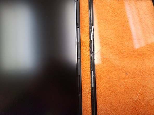

    10. Amazon Fire HD 8 (8th Gen) Digitizer Replacement, Separate the Digitizer (4): crwdns2935265:010crwdnd2935265:01crwdnd2935265:03crwdne2935265:0 Amazon Fire HD 8 (8th Gen) Digitizer Replacement, Separate the Digitizer (4): crwdns2935265:010crwdnd2935265:02crwdnd2935265:03crwdne2935265:0 Amazon Fire HD 8 (8th Gen) Digitizer Replacement, Separate the Digitizer (4): crwdns2935265:010crwdnd2935265:03crwdnd2935265:03crwdne2935265:0
      • Taking extra care around the caution areas mentioned in the previous step, use a final opening pick to slice through the adhesive on the top edge.
      • Once the adhesive is cut through, lift the digitizer from the bottom edge, keeping the top edge connected.
      • Avoid straining the ribbon cable, as it is delicate and can cause issues on the motherboard.
      • Extend the digitizer to a 180 degree angle and flip the device over.
      • Make sure you have a microfiber or other soft cloth down, to prevent scratches or scuffs to the LCD screen.

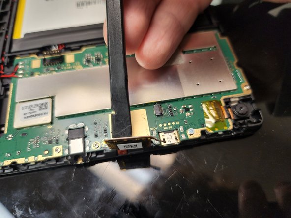

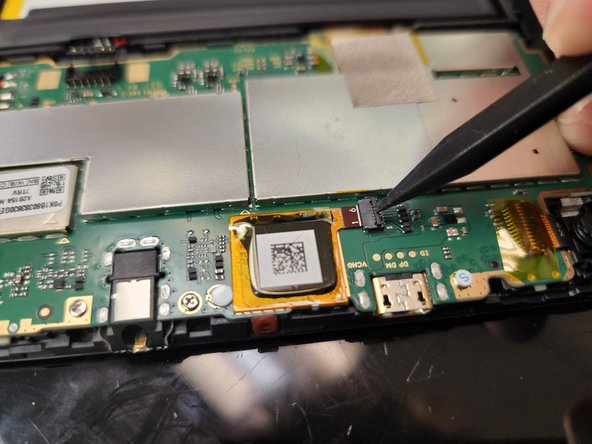

    11. Amazon Fire HD 8 (8th Gen) Digitizer Replacement, Disconnect the Digitizer (1): crwdns2935265:011crwdnd2935265:01crwdnd2935265:03crwdne2935265:0 Amazon Fire HD 8 (8th Gen) Digitizer Replacement, Disconnect the Digitizer (1): crwdns2935265:011crwdnd2935265:02crwdnd2935265:03crwdne2935265:0 Amazon Fire HD 8 (8th Gen) Digitizer Replacement, Disconnect the Digitizer (1): crwdns2935265:011crwdnd2935265:03crwdnd2935265:03crwdne2935265:0
      • Remove the tape holding the ribbon connector down.
      • Using the tip of your spudger, lift the locking clip of the connector to release the ribbon cable.
      • Using your tweezers, remove the ribbon cable from the connector.

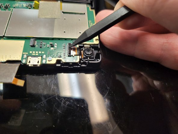

    13. Amazon Fire HD 8 (8th Gen) Digitizer Replacement, Disconnect the Camera: crwdns2935265:013crwdnd2935265:01crwdnd2935265:03crwdne2935265:0 Amazon Fire HD 8 (8th Gen) Digitizer Replacement, Disconnect the Camera: crwdns2935265:013crwdnd2935265:02crwdnd2935265:03crwdne2935265:0 Amazon Fire HD 8 (8th Gen) Digitizer Replacement, Disconnect the Camera: crwdns2935265:013crwdnd2935265:03crwdnd2935265:03crwdne2935265:0

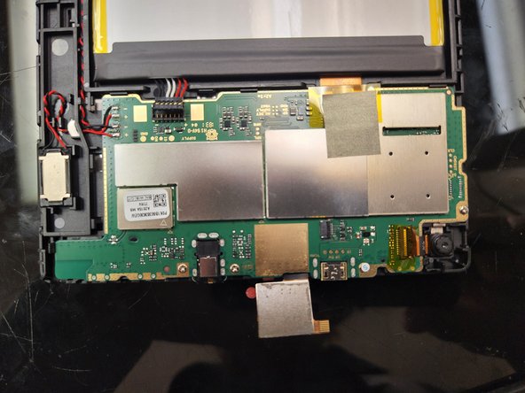

    14. Amazon Fire HD 8 (8th Gen) Digitizer Replacement, Circuit Board: crwdns2935265:014crwdnd2935265:01crwdnd2935265:03crwdne2935265:0 Amazon Fire HD 8 (8th Gen) Digitizer Replacement, Circuit Board: crwdns2935265:014crwdnd2935265:02crwdnd2935265:03crwdne2935265:0 Amazon Fire HD 8 (8th Gen) Digitizer Replacement, Circuit Board: crwdns2935265:014crwdnd2935265:03crwdnd2935265:03crwdne2935265:0
      • Remove the four screws (blue). The screws are identical and interchangeable, so you don't need to keep track of which screw went where.
      • Note that one screw is covered with a sticker. Don't miss this one or you may crack the circuit board.
      • Release the two locking clips (yellow). The clips are holding the board down on the corners and it cannot be released easily without pulling back on them.
      • The board only needs to be lifted enough to let the digitizer connector through, it does not need to be removed completely.
      • Take note of the speaker wires (red). They are soldered onto the board and special care should be taken to ensure they are not broken or otherwise disconnected.

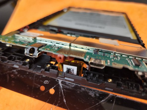

    15. Amazon Fire HD 8 (8th Gen) Digitizer Replacement, Remove the Old Digitizer: crwdns2935265:015crwdnd2935265:01crwdnd2935265:03crwdne2935265:0 Amazon Fire HD 8 (8th Gen) Digitizer Replacement, Remove the Old Digitizer: crwdns2935265:015crwdnd2935265:02crwdnd2935265:03crwdne2935265:0 Amazon Fire HD 8 (8th Gen) Digitizer Replacement, Remove the Old Digitizer: crwdns2935265:015crwdnd2935265:03crwdnd2935265:03crwdne2935265:0
      • With the adhesive cut and the motherboard released, lift it up and gently work the digitizer connector out of the hole.
      • You will have to work backwards and slide the digitizer back under the device to maneuver the ribbon connector through the hole in the frame.
      • When the connector is through the hole, pull the entire digitizer out. If you continue pushing through, the hard corners on the connector can scratch the LCD underneath.
