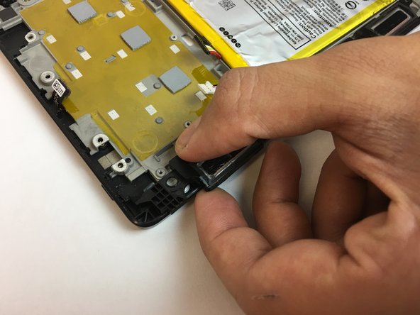

  10. Amazon Fire HD 7 (4th Generation) Speaker: crwdns2935265:010crwdnd2935265:01crwdnd2935265:03crwdne2935265:0 Amazon Fire HD 7 (4th Generation) Speaker: crwdns2935265:010crwdnd2935265:02crwdnd2935265:03crwdne2935265:0 Amazon Fire HD 7 (4th Generation) Speaker: crwdns2935265:010crwdnd2935265:03crwdnd2935265:03crwdne2935265:0
    • Gently pry the speaker from the device with the iFixit opening tool.
    • If the speaker does not immediately pop out, grab it by the top and slide it out sideways away from the device, while applying a slight upward force.
    • Remove the speaker.
