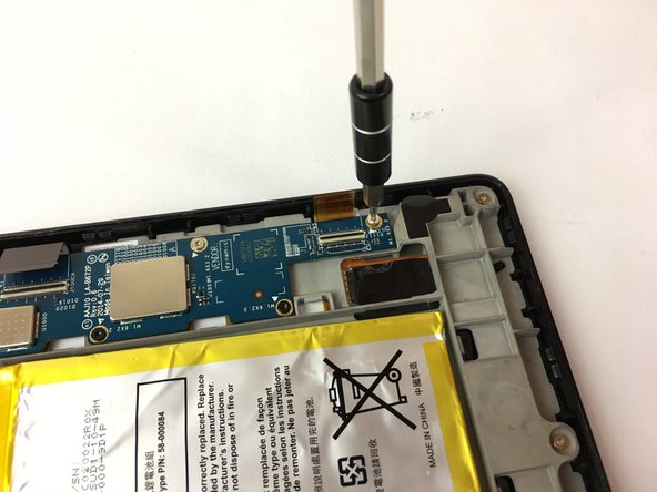

      • Remove the nine silver screws located around the motherboard with the T5 Torx screwdriver.
    4. Amazon Fire HD 7 (4th Generation) Display Replacement: crwdns2935265:04crwdnd2935265:01crwdnd2935265:03crwdne2935265:0 Amazon Fire HD 7 (4th Generation) Display Replacement: crwdns2935265:04crwdnd2935265:02crwdnd2935265:03crwdne2935265:0 Amazon Fire HD 7 (4th Generation) Display Replacement: crwdns2935265:04crwdnd2935265:03crwdnd2935265:03crwdne2935265:0

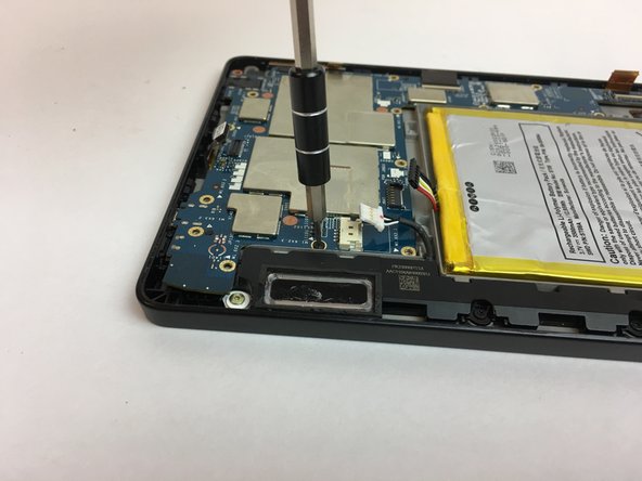

      • Remove the six black screws located around the battery and the speaker with the T5 Torx screwdriver.
      • Make your way around the battery and speaker to remove all of them.
    5. Amazon Fire HD 7 (4th Generation) Display Replacement: crwdns2935265:05crwdnd2935265:01crwdnd2935265:03crwdne2935265:0 Amazon Fire HD 7 (4th Generation) Display Replacement: crwdns2935265:05crwdnd2935265:02crwdnd2935265:03crwdne2935265:0 Amazon Fire HD 7 (4th Generation) Display Replacement: crwdns2935265:05crwdnd2935265:03crwdnd2935265:03crwdne2935265:0
      • Carefully unplug the three wire connections by placing a plastic spudger under the connections and lifting up.
      • Disconnect the battery and speaker connections by placing the round handle spudger under the wires and lifting up and out.
      • Disconnect the display connections from the motherboard by using the plastic spudger to lift the clamp holding the ribbon cable. Then, using the tweezers, grab the ribbon wire and pull away from the motherboard.

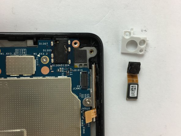

      • Remove the two screws holding the rear camera in place using the T5 Torx screwdriver.
      • Once freed from the screws, gently lift and remove the rear camera.
      • The camera lens is sensitive. Be careful when removing and handling the rear camera.

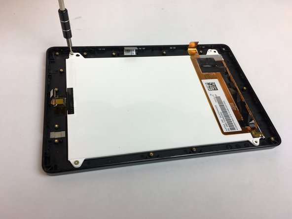

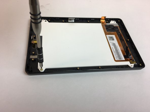

      • Remove the (4) T5 hex silver screws in the corners of the display screen using the T5 torx screwdriver.

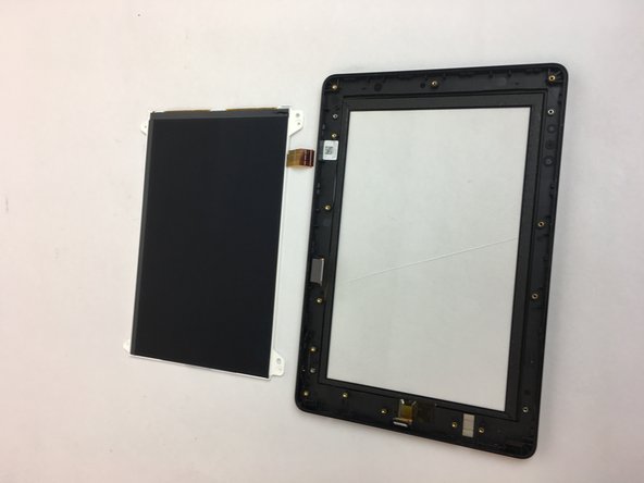

    4. Amazon Fire HD 7 (4th Generation) Display Replacement: crwdns2935265:011crwdnd2935265:01crwdnd2935265:03crwdne2935265:0 Amazon Fire HD 7 (4th Generation) Display Replacement: crwdns2935265:011crwdnd2935265:02crwdnd2935265:03crwdne2935265:0 Amazon Fire HD 7 (4th Generation) Display Replacement: crwdns2935265:011crwdnd2935265:03crwdnd2935265:03crwdne2935265:0
      • The LCD display screen may now be removed and replaced.
