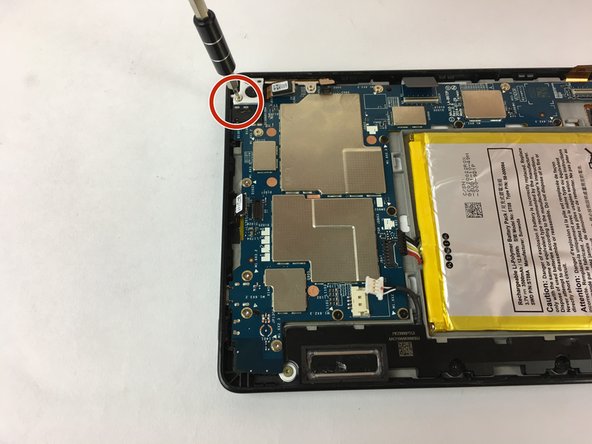

  4. Amazon Fire HD 7 (4th Generation)  Rear facing camera replacement: crwdns2935265:04crwdnd2935265:01crwdnd2935265:02crwdne2935265:0 Amazon Fire HD 7 (4th Generation)  Rear facing camera replacement: crwdns2935265:04crwdnd2935265:02crwdnd2935265:02crwdne2935265:0
    • Unscrew the two screws using a T5 screwdriver.
    • The camera lens are sensitive. Be careful when removing and handling camera.
    • Once freed from the screws, gently lift and remove the camera.
