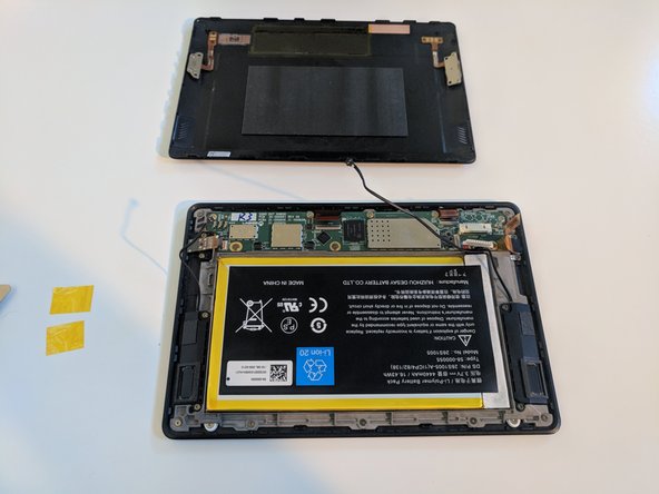

    1. Amazon Fire HD 3rd Gen Disassembly, Pry off the plastic back.: crwdns2935265:01crwdnd2935265:01crwdnd2935265:03crwdne2935265:0 Amazon Fire HD 3rd Gen Disassembly, Pry off the plastic back.: crwdns2935265:01crwdnd2935265:02crwdnd2935265:03crwdne2935265:0 Amazon Fire HD 3rd Gen Disassembly, Pry off the plastic back.: crwdns2935265:01crwdnd2935265:03crwdnd2935265:03crwdne2935265:0
      • Using a Jimmy, start at the volume control and work your way around by prying off the back and then lifting it back like a book.
    2. Amazon Fire HD 3rd Gen Disassembly, Peeling off the tape.: crwdns2935265:02crwdnd2935265:01crwdnd2935265:03crwdne2935265:0 Amazon Fire HD 3rd Gen Disassembly, Peeling off the tape.: crwdns2935265:02crwdnd2935265:02crwdnd2935265:03crwdne2935265:0 Amazon Fire HD 3rd Gen Disassembly, Peeling off the tape.: crwdns2935265:02crwdnd2935265:03crwdnd2935265:03crwdne2935265:0
      • Peel off the 2 yellow pieces of yellow tape on the battery.

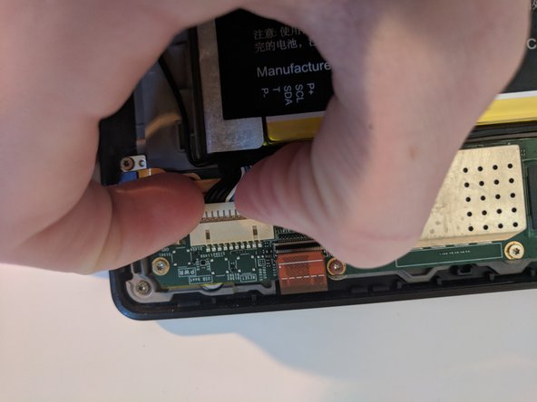

    3. Amazon Fire HD 3rd Gen Disassembly, Disconnect the ribbon cables: crwdns2935265:03crwdnd2935265:01crwdnd2935265:03crwdne2935265:0 Amazon Fire HD 3rd Gen Disassembly, Disconnect the ribbon cables: crwdns2935265:03crwdnd2935265:02crwdnd2935265:03crwdne2935265:0 Amazon Fire HD 3rd Gen Disassembly, Disconnect the ribbon cables: crwdns2935265:03crwdnd2935265:03crwdnd2935265:03crwdne2935265:0
      • Take off all the ribbon cables connected to the main board. (Marked in Red)
      • On the 2 speakers marked in yellow, be sure to pull straight up. Then unclip the speaker cables.
