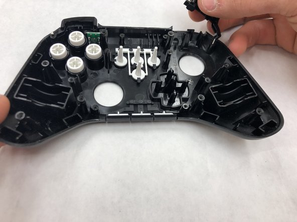

  6. Amazon Fire Game Controller Outer Shell Replacement, Outer Shell: crwdns2935265:06crwdnd2935265:01crwdnd2935265:01crwdne2935265:0
    • Use a JIS #0 screwdriver to remove the two 7 mm screws from the retaining bracket that secures the play, stop, and pause button wiring.
  7. Amazon Fire Game Controller Outer Shell Replacement: crwdns2935265:07crwdnd2935265:01crwdnd2935265:01crwdne2935265:0
    • Use a JIS #0 screwdriver to unscrew the 5 mm screws from the LED indicator assembly.
  8. Amazon Fire Game Controller Outer Shell Replacement: crwdns2935265:08crwdnd2935265:01crwdnd2935265:02crwdne2935265:0 Amazon Fire Game Controller Outer Shell Replacement: crwdns2935265:08crwdnd2935265:02crwdnd2935265:02crwdne2935265:0
    • Slide out the triggers and bumpers.
