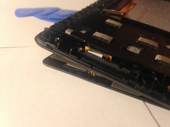

  1. Amazon Fire 5th Generation Teardown, Starting to open the Kindle Fire 7" (2015 5th Gen) Model SV98LN: crwdns2935265:01crwdnd2935265:01crwdnd2935265:03crwdne2935265:0 Amazon Fire 5th Generation Teardown, Starting to open the Kindle Fire 7" (2015 5th Gen) Model SV98LN: crwdns2935265:01crwdnd2935265:02crwdnd2935265:03crwdne2935265:0 Amazon Fire 5th Generation Teardown, Starting to open the Kindle Fire 7" (2015 5th Gen) Model SV98LN: crwdns2935265:01crwdnd2935265:03crwdnd2935265:03crwdne2935265:0
    • Locate the seam between the back cover and the front frame and begin prying the back cover off by inserting an opening tool into the seam.
    • Use a pick or opening tool to work from one side down to the bottom and then up the other side while popping the clips that hold the back cover to the front frame.

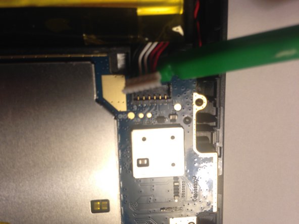

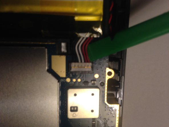

  3. Amazon Fire 5th Generation Teardown, Disconnecting the battery: crwdns2935265:03crwdnd2935265:01crwdnd2935265:03crwdne2935265:0 Amazon Fire 5th Generation Teardown, Disconnecting the battery: crwdns2935265:03crwdnd2935265:02crwdnd2935265:03crwdne2935265:0 Amazon Fire 5th Generation Teardown, Disconnecting the battery: crwdns2935265:03crwdnd2935265:03crwdnd2935265:03crwdne2935265:0
    • The battery should be disconnected before continuing beyond this point.
    • Using a spudger, lift from underneath the power wires to release the connector.

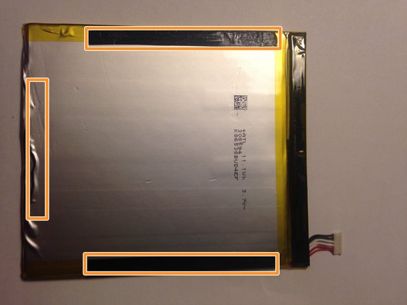

  4. Amazon Fire 5th Generation Teardown, Removing the battery: crwdns2935265:04crwdnd2935265:01crwdnd2935265:02crwdne2935265:0 Amazon Fire 5th Generation Teardown, Removing the battery: crwdns2935265:04crwdnd2935265:02crwdnd2935265:02crwdne2935265:0
    • The battery is held to the plastic frame using adhesive strips on the sides and bottom of the battery (orange).
    • Using a spudger lift the bottom corner of the battery and insert the spudger between the battery and plastic frame.
    • WARNING: Heat may be needed to release the adhesive without damaging the battery.

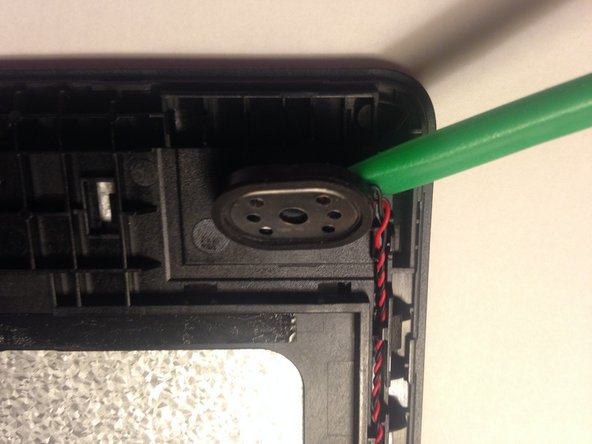

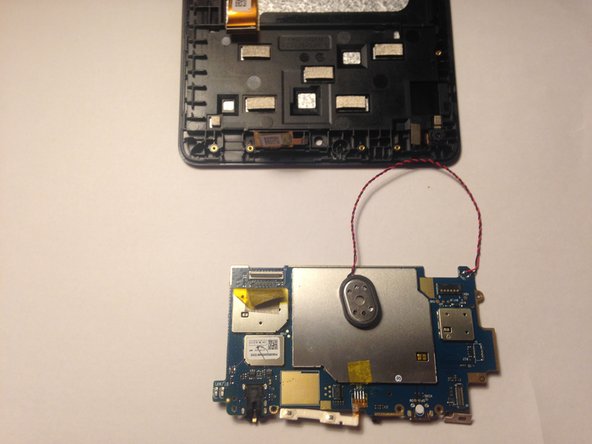

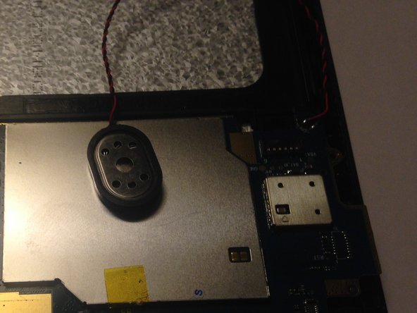

  5. Amazon Fire 5th Generation Teardown, Detach Speaker: crwdns2935265:05crwdnd2935265:01crwdnd2935265:02crwdne2935265:0 Amazon Fire 5th Generation Teardown, Detach Speaker: crwdns2935265:05crwdnd2935265:02crwdnd2935265:02crwdne2935265:0
    • Use a spudger to remove the speaker that is adhered to the frame with adhesive.
    • WARNING: Heat may be needed to release the adhesive enough to remove the speaker.

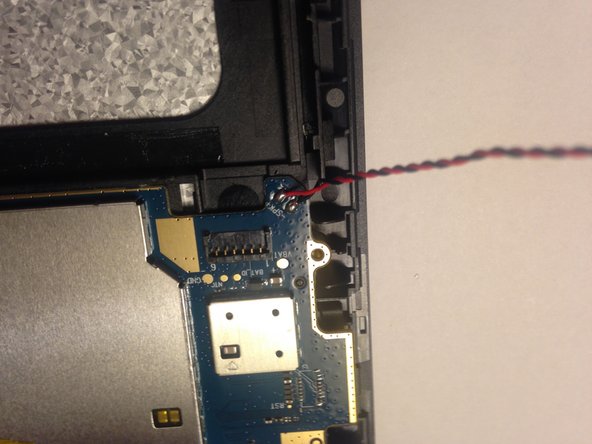

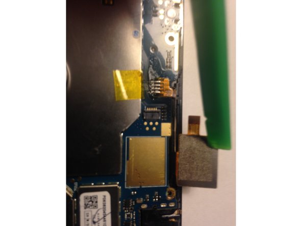

  6. Amazon Fire 5th Generation Teardown, Speaker Wire: crwdns2935265:06crwdnd2935265:01crwdnd2935265:03crwdne2935265:0 Amazon Fire 5th Generation Teardown, Speaker Wire: crwdns2935265:06crwdnd2935265:02crwdnd2935265:03crwdne2935265:0 Amazon Fire 5th Generation Teardown, Speaker Wire: crwdns2935265:06crwdnd2935265:03crwdnd2935265:03crwdne2935265:0
    • After the speaker is detached, pull the speaker wire out of the channel it is in carefully.
    • Set the speaker out of the way. On top of the silver microchip cover on the main pcb is a great place for it.

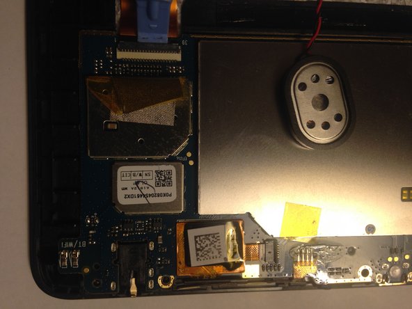

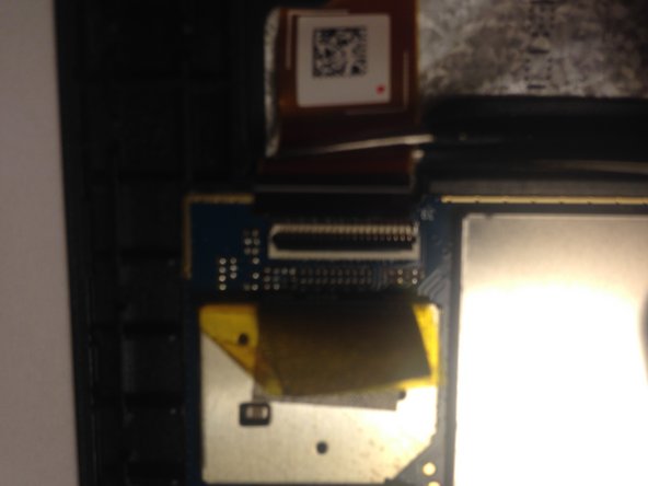

  7. Amazon Fire 5th Generation Teardown, LCD connector and cable: crwdns2935265:07crwdnd2935265:01crwdnd2935265:03crwdne2935265:0 Amazon Fire 5th Generation Teardown, LCD connector and cable: crwdns2935265:07crwdnd2935265:02crwdnd2935265:03crwdne2935265:0 Amazon Fire 5th Generation Teardown, LCD connector and cable: crwdns2935265:07crwdnd2935265:03crwdnd2935265:03crwdne2935265:0
    • Apply a little heat from a 200 degree heat gun to loosen the adhesive on the tape covering the LCD connector.
    • Peel up the tape with tweezers. Fold it back on itself to get it out of the way.
    • Using an opening tool lift the release lever of the LCD connector.
    • Using tweezers put the LCD cable out of the LCD connector.

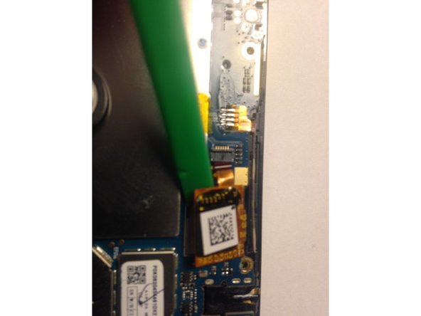

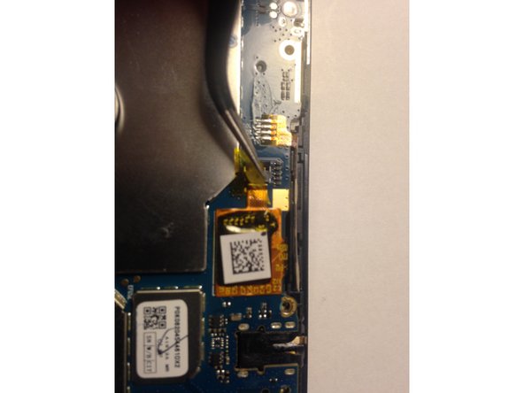

  8. Amazon Fire 5th Generation Teardown, Digitizer conector and cable assembly: crwdns2935265:08crwdnd2935265:01crwdnd2935265:03crwdne2935265:0 Amazon Fire 5th Generation Teardown, Digitizer conector and cable assembly: crwdns2935265:08crwdnd2935265:02crwdnd2935265:03crwdne2935265:0 Amazon Fire 5th Generation Teardown, Digitizer conector and cable assembly: crwdns2935265:08crwdnd2935265:03crwdnd2935265:03crwdne2935265:0
    • Heat the tape covering the digitizer connector then remove the tape with tweezers and set aside.
    • Use an opening tool to lift the lever of the connector to release the cable from the connector.

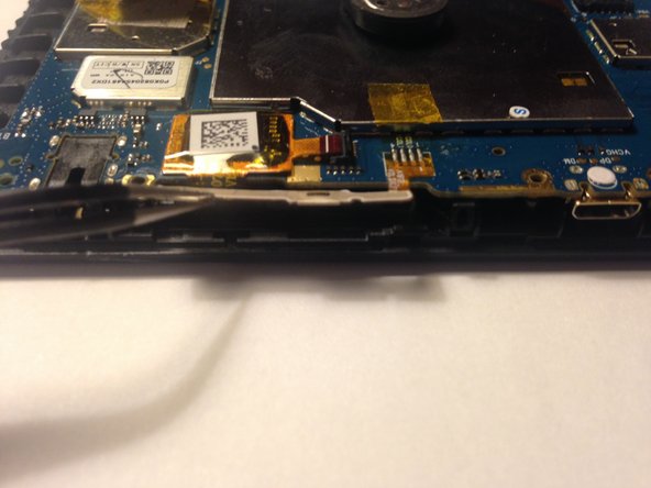

  9. Amazon Fire 5th Generation Teardown, Digitizer connector and cable assembly Part 2: crwdns2935265:09crwdnd2935265:01crwdnd2935265:03crwdne2935265:0 Amazon Fire 5th Generation Teardown, Digitizer connector and cable assembly Part 2: crwdns2935265:09crwdnd2935265:02crwdnd2935265:03crwdne2935265:0 Amazon Fire 5th Generation Teardown, Digitizer connector and cable assembly Part 2: crwdns2935265:09crwdnd2935265:03crwdnd2935265:03crwdne2935265:0
    • With the cable released, heat the cable assembly to warm the adhesive enough to loosen it.
    • Using a spudger, lift the cable assembly from the main pcb carefully.
    • Fold it out of the way so that the pcb can be removed around it.

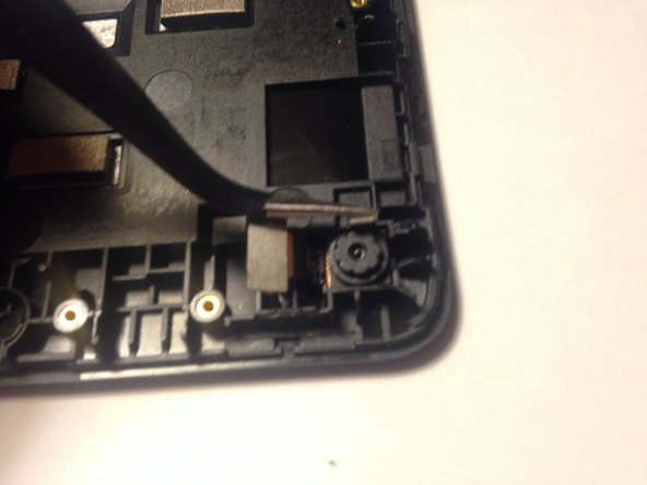

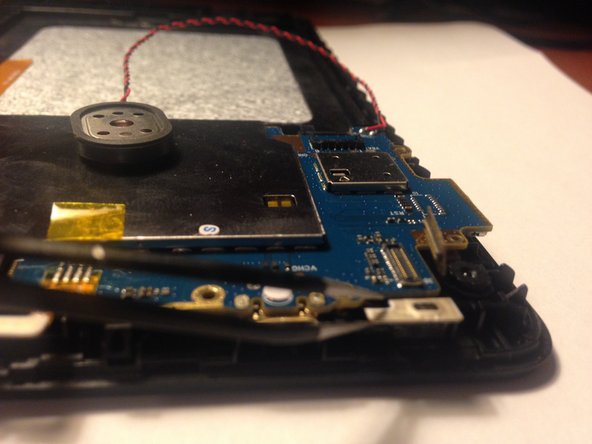

  10. Amazon Fire 5th Generation Teardown, Rear facing camera: crwdns2935265:010crwdnd2935265:01crwdnd2935265:02crwdne2935265:0 Amazon Fire 5th Generation Teardown, Rear facing camera: crwdns2935265:010crwdnd2935265:02crwdnd2935265:02crwdne2935265:0
    • Use a plastic opening tool to lift the rear facing camera connector off the pcb.

  13. Amazon Fire 5th Generation Teardown, Remove the PCB: crwdns2935265:013crwdnd2935265:01crwdnd2935265:02crwdne2935265:0 Amazon Fire 5th Generation Teardown, Remove the PCB: crwdns2935265:013crwdnd2935265:02crwdnd2935265:02crwdne2935265:0
    • Now that all the connectors are removed and the cables released from the plastic frame, the PCB can be removed.
    • Lift the PCB from the side opposite the headphone jack and carefully work is loose.
    • Be careful not to catch any of the cables so as not to damage them.

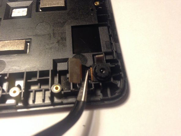

  14. Amazon Fire 5th Generation Teardown, Remove Rear Facing Camera: crwdns2935265:014crwdnd2935265:01crwdnd2935265:03crwdne2935265:0 Amazon Fire 5th Generation Teardown, Remove Rear Facing Camera: crwdns2935265:014crwdnd2935265:02crwdnd2935265:03crwdne2935265:0 Amazon Fire 5th Generation Teardown, Remove Rear Facing Camera: crwdns2935265:014crwdnd2935265:03crwdnd2935265:03crwdne2935265:0
    • Use tweezers to pull up the conductive tape from the frame, then lift the camera out of the frame.

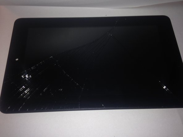

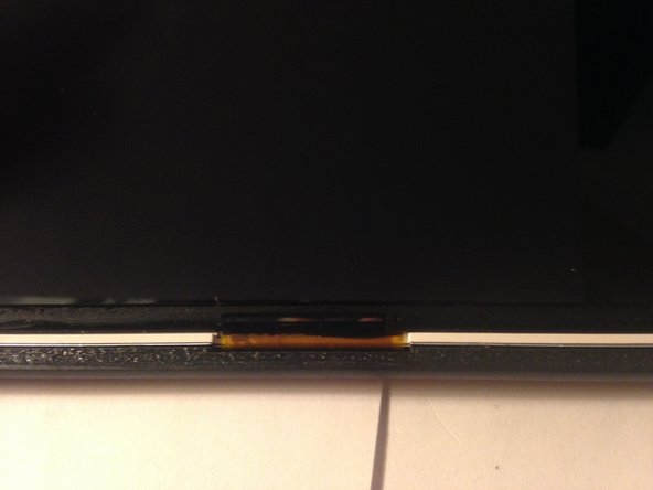

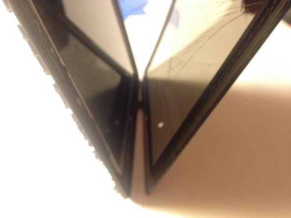

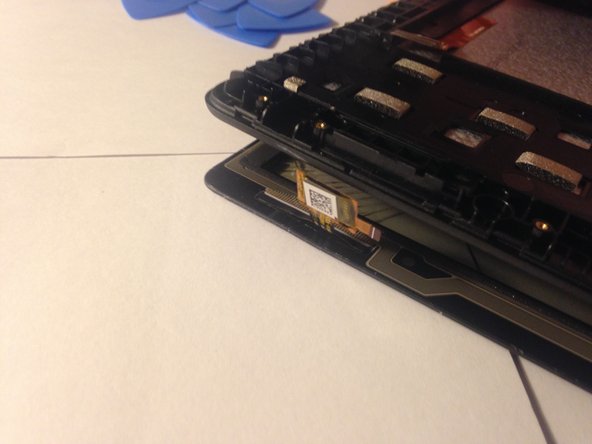

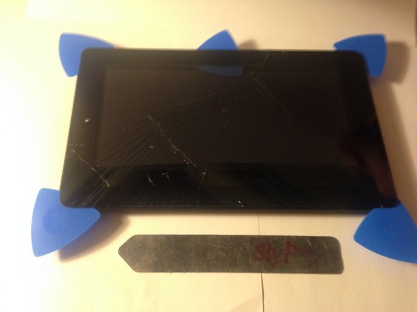

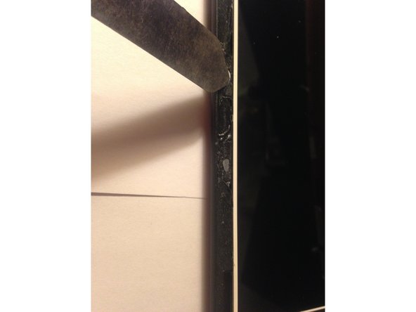

  16. Amazon Fire 5th Generation Teardown, Removing the digitizer (front glass): crwdns2935265:016crwdnd2935265:01crwdnd2935265:03crwdne2935265:0 Amazon Fire 5th Generation Teardown, Removing the digitizer (front glass): crwdns2935265:016crwdnd2935265:02crwdnd2935265:03crwdne2935265:0 Amazon Fire 5th Generation Teardown, Removing the digitizer (front glass): crwdns2935265:016crwdnd2935265:03crwdnd2935265:03crwdne2935265:0
    • Use generous amounts of heat in a cyclical manner to evenly heat the front glass.
    • Using a SlyPry, slowly work the front glass out of the front plastic frame, while continually applying heat to the area being worked.
    • The adhesive is very thick around the outside of the glass and will take a long time and lots of heat to get it loose.
    • As you work around the edges, place guitar picks or iFixit triangle tools between the glass and the plastic frame.

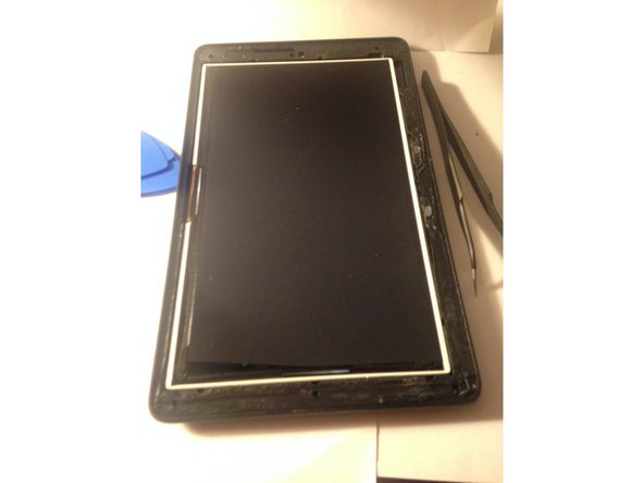

    • Once all of the adhesive is released separate slowly and notice the cable.
  17. Amazon Fire 5th Generation Teardown, Unthread the digitizer cable: crwdns2935265:017crwdnd2935265:01crwdnd2935265:03crwdne2935265:0 Amazon Fire 5th Generation Teardown, Unthread the digitizer cable: crwdns2935265:017crwdnd2935265:02crwdnd2935265:03crwdne2935265:0 Amazon Fire 5th Generation Teardown, Unthread the digitizer cable: crwdns2935265:017crwdnd2935265:03crwdnd2935265:03crwdne2935265:0
    • The digitizer cable is threaded through a slit in the plastic frame. Unthread this cable carefully if you need to save your digitizer.

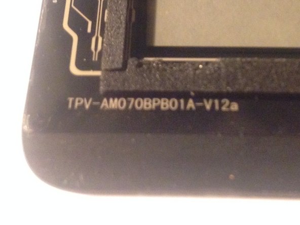

  18. Amazon Fire 5th Generation Teardown, The digitizer part number: crwdns2935265:018crwdnd2935265:01crwdnd2935265:02crwdne2935265:0 Amazon Fire 5th Generation Teardown, The digitizer part number: crwdns2935265:018crwdnd2935265:02crwdnd2935265:02crwdne2935265:0
    • The part number of the digitizer and/or digitizer cable is TPV-AM070BPB01A-V12a. It also says 008-1531-P2.
    • I don't read Chinese, but the part is available from a single Chinese website at the following URLs. Link 1 Link 2
    • If someone is able to buy some, please let me know so that I can buy several from you as replacements for the one I broke and will most likely brake again.
