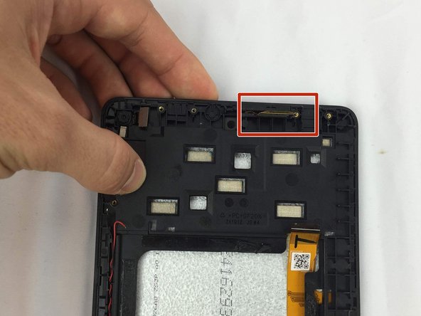

    • The LCD- Motherboard connector cable has a protective overlay that you must peel back with precision tweezers in order to expose the actual connector.
    • Gently pull down on the connector cable using precision tweezers in order to disconnect the cable.
    • The LCD Digitizer on the Amazon Fire tablet has a locking cable connector that holds it in place on the motherboard.
    • To remove the cable, use the iFixit Opening Tool to unlock the LCD Digitizer cable connector.
    • Once the wire connector is removed, use the iFixit Opening Tool to pry the entire LCD Digitizer away from the motherboard.
    • Remove any tape that may be covering the connector.

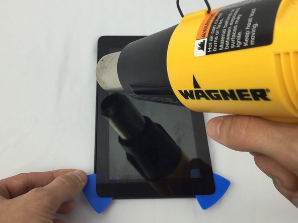

  10. Amazon Fire 5th Generation Screen and LCD Replacement: crwdns2935265:012crwdnd2935265:01crwdnd2935265:03crwdne2935265:0 Amazon Fire 5th Generation Screen and LCD Replacement: crwdns2935265:012crwdnd2935265:02crwdnd2935265:03crwdne2935265:0 Amazon Fire 5th Generation Screen and LCD Replacement: crwdns2935265:012crwdnd2935265:03crwdnd2935265:03crwdne2935265:0

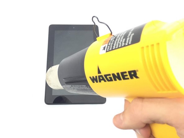

    • Use a heating tool such as an iOpener or Heat gun around the edges of the Amazon Fire's glass screen. The iOpener may take longer to use. However, a heat gun can warp the plastic if used incorrectly.
    • As you heat the edges, use a separator tool such as a guitar pick to lift the glass panel up and hold it up as you work around the device.
    • Do not use a separation tool on the top edge of the device where the front camera would be; the digitizer cable is located in this location and can easily be severed. Instead, work in a U shape until you have 3 sides lifted from the frame
    • Be patient with this step because it can be very time consuming and remember to use proper safety gear when using a heating device.

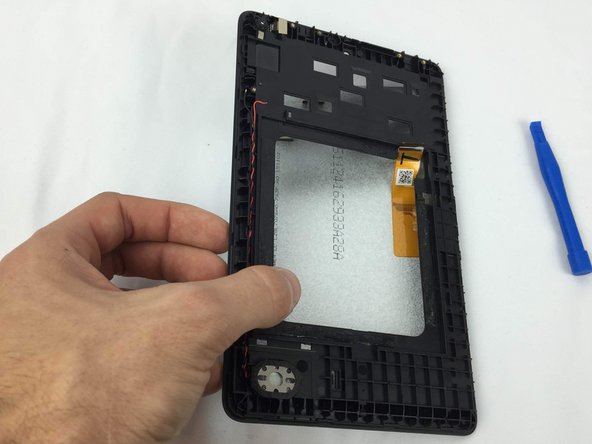

  12. Amazon Fire 5th Generation Screen and LCD Replacement: crwdns2935265:014crwdnd2935265:01crwdnd2935265:02crwdne2935265:0 Amazon Fire 5th Generation Screen and LCD Replacement: crwdns2935265:014crwdnd2935265:02crwdnd2935265:02crwdne2935265:0
    • To remove the LCD panel, flip the device over and detach the LCD digitizer cable from the frame if they have become stuck together.
    • You can use the iFixit Opening Tool to separate the LCD panel from the adhesive and it should come out of place with ease.
